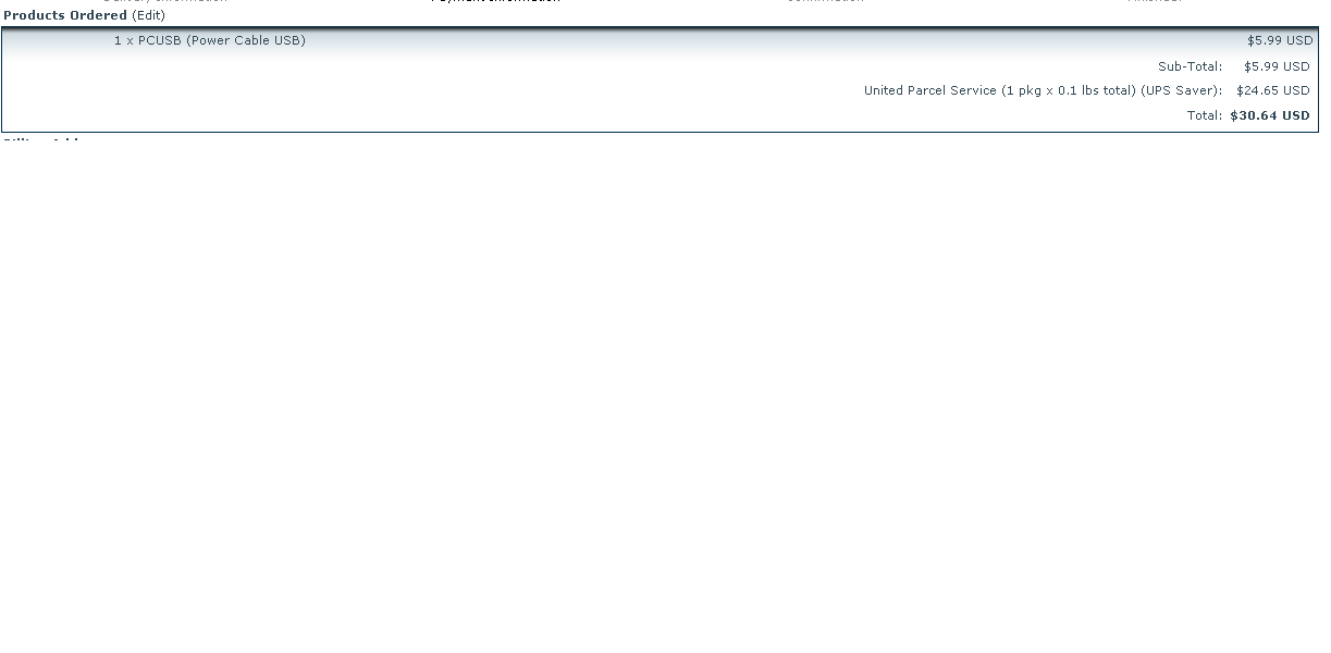

My question is this. I want to switch to USB power instead of the MOLEX connector cable that the unit came with. In the store there is a PCUSB power connector that is supposed to work. I clicked on the order page, and it shows that it will cost 25 dollars to ship the 6 dollar cable! Since it seems to be just a slightly modded usb cable I was wondering if there was a diagram somewhere that would show someone like me how to do it myself? I have been searching for a while and cannot find one on the site. I am not very advanced with a soddering Iron, but can follow directions well. :) Any help would be appreciated. Otherwise it will go back into the box I have had it in all this time.
