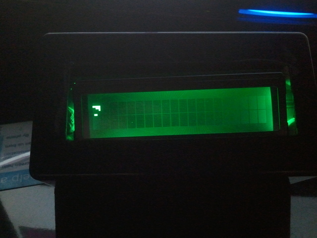

Basically when sending commands such as 0xFE, 0x58 to clear the screen it will clear but sending another command after wont work or if i send a string it seems to drop the first character. If i send nulls after a command it seems to work but leaves some strange character behind.
The picture with the X in the bottom row is without sending nulls and the other picture with the strange character is with sending nulls, both from sending a test string, sending the turn on command and then clearing the screen.
The other picture is from not sending nulls but sending the string, turning the screen on, sending the string again.

- With nulls
- 2010-11-22 17.12.05.jpg (92.01 KiB) Viewed 31957 times
- without nulls
- 2010-11-22 19.34.07.jpg (99.15 KiB) Viewed 31956 times
- no nulls but string between commands
- 2010-11-22 19.57.23.jpg (99.21 KiB) Viewed 31956 times

Finally, if you're curious, the X is of course hex 58, the clear screen command byte, and the strange symbol is the top left corner of our logo from the start screen. This character appears when the display receives a 0 value.
