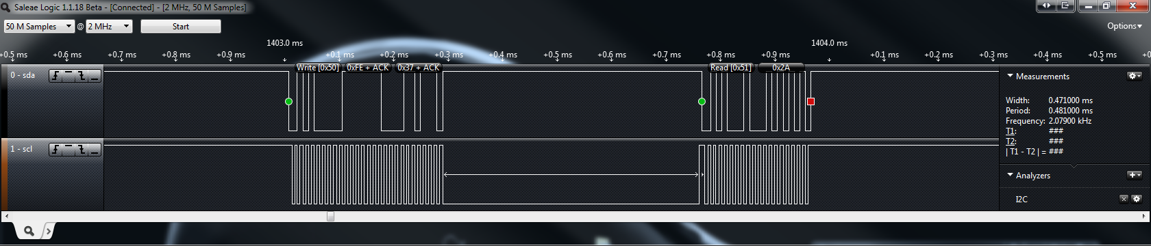

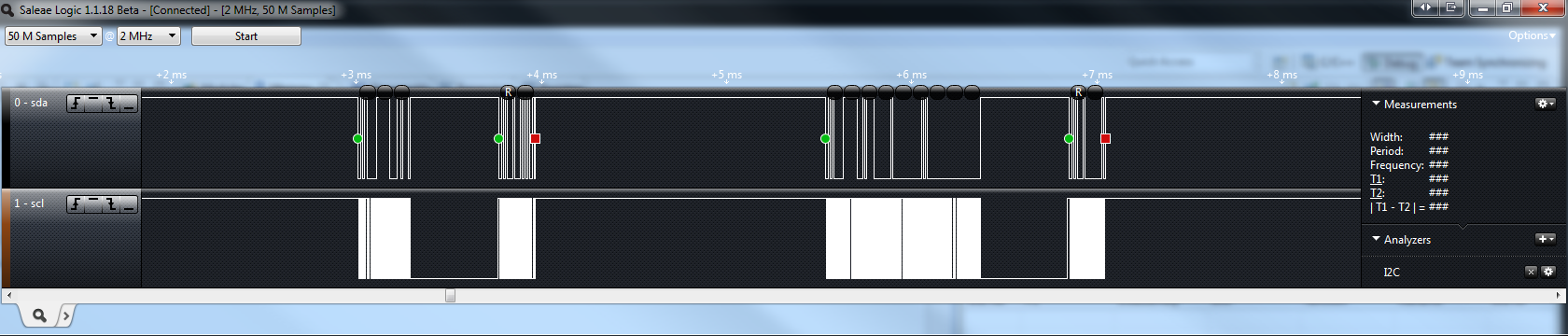

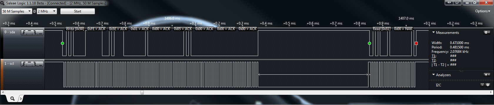

If you want to have a look at my timings, I've attacced three screen captures :
- the whole transaction
- the module read
- the bitmap file transfer init
Please note I've already set the protocol answer to I2C mode as I'm properly reading the module type.
I've a delay of around 1.5ms between the two transactions and 476µs between the last read ACK and the beginning of the read start condition associated to the command.
Thank you for your answer and the time you're spending on my issue.

Re: GLK LCD header
Hello Laurent,
I've finished tweaking what simple code I have and uploaded to both our .ca support site and GitHub C project page. I've included your library which came in handy, thanks again.
The biggest issues I had were in timing, which is why you'll see rather large delays of 10ms between each individual byte write and 50ms after each write transaction. I found without these delays I was either reading when there was no data available (0x00), or reading what I had just written (0xFE, 0x05, 0x01, etc). These delays will be different for every controller, typically you'll start with large values and reduce them to the point where communication is just on the comfortable side.
Your implementation appears correct; bytes are transmitted little endian style and the logic analyzer output looks good. Please try delays using the Arduino code as a reference and let me know if you have any further trouble.
