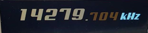

Got it mostly working. A few glitches, but got the basics down. When creating labels, I can update without having to clear first, so that's cool. Here's my first successful attempt to write the Aero font, using individual labels for each position, so I can center each character in the block. That gets around the problem with it being a proportional font, which makes the display jump back and forth as it writes a whole string. The color is a little off in the photo - it's actually orange, brown and white. Looks pretty cool!
[img]
[/img]
Re: GTT38 text insertion doesn't clear
Hello Brian,
It looks really good so far. Nice job ! :)
-Daniel
