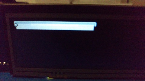

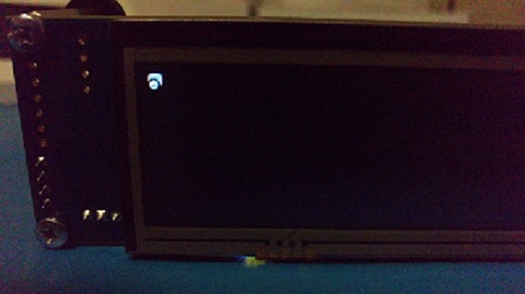

I'm glad you were able to get the slider example working. If you only used the minimum suggested values, the slider will appear as two buttons overlapping. See image below:
Minimum Slider
Minimum Slider

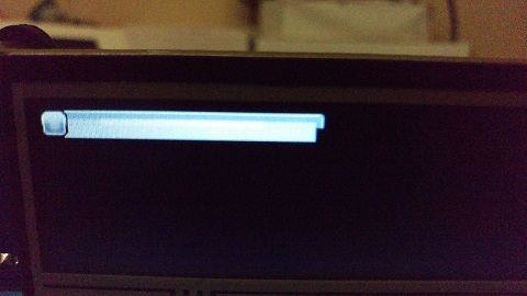

Adjusting the TrkWth will determine how long you slider is. The image below has a TrkWth of 200.
TrkWth 200
TrkWth 200

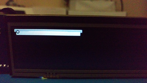

Adjusting the TrkHgt will determine the height of your slider. The image below has a TrkHgt of 200.
TrkHgt 20
TrkHgt 20
Adjusting the BtnWth will determine how wide your button is, while BtnHgt determines the height of your button. The image below has a BtnWth and BtnHgt of 20.
BtnWth and BtnHgt 20
