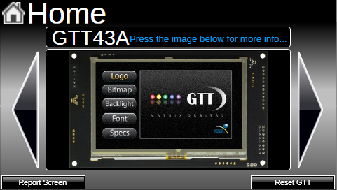

In this example, a simple menu interface is generated and deployed to a GTT43A display using the GTT Designer Software tool.
Multiple elements are implemented in the project, allowing a user to navigate between GTT products, while also keeping track of what screen is being currently displayed. This example utilizes scripts to transition between screens, along with the echo command to return what screen is being displayed.

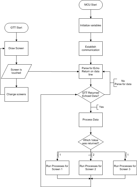

Using the GTT Designer's Pre and Post scripting features, echoed messages can be used to determine if the GTT has changed screens. When developing a screen in the Designer, you can add a post script to Echo a value, like a screen number. On your controller's side, you would have to periodically check the I2C's return line to see if an Echo message was sent from the GTT. Once your controller is notified that a screen transition has occurred, it can decide what to do next.
I've attached a flow chart to demonstrate the coding approach that was taken with this appnote: If you download the Arduino environment, and open the screen tracking program, you should be able to follow along fairly easily. The Arduino will initialize variables, and then start a loop parser, checking whether or not the GTT has changed it's screen, among other things. When the GTT has changed screens, the Arduino will be notified, and determine what to do next using a case structure.
