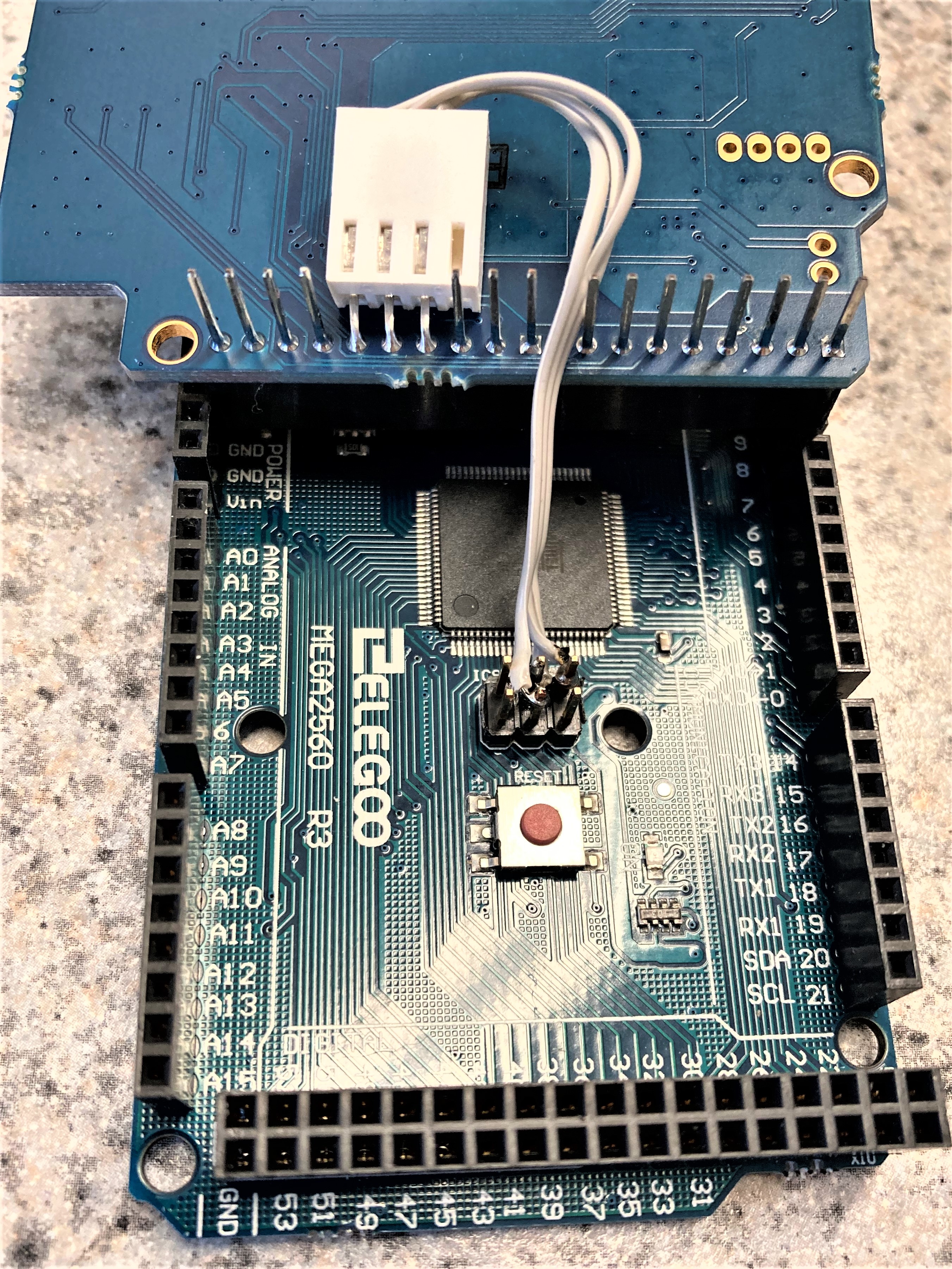

The shield is not compatible with the Mega2560, there is no SPI on the pins the Uno is using for SPI.
You could either use jumper cables between the shield and the Mega2560, or use software-SPI.

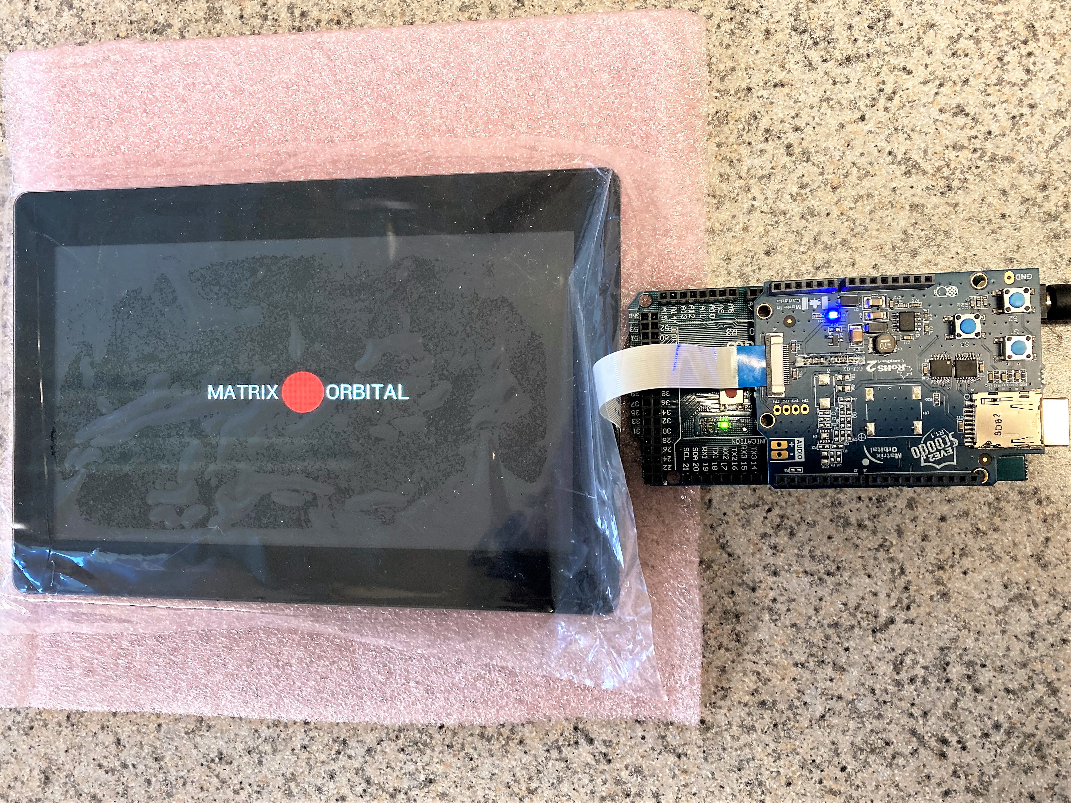

Yes. That is what I discovered. There is a way to change this in software, but it would be managing the SPI with software instead of the UART and the results are likely to be poor. The UART SPI connects to the Mega pins 50, 51, and 52. The Uno-to-Mega connection pins are: 11>51 12>50 13>52. The only solution is to do a physical connection. The attached pictures illustrate how I resolved this. The three shield pins 11, 12, and 13 are bent inward and connected with a plug and wires to the Mega pins 51, 50 and 52. The display is now working with this modification.
