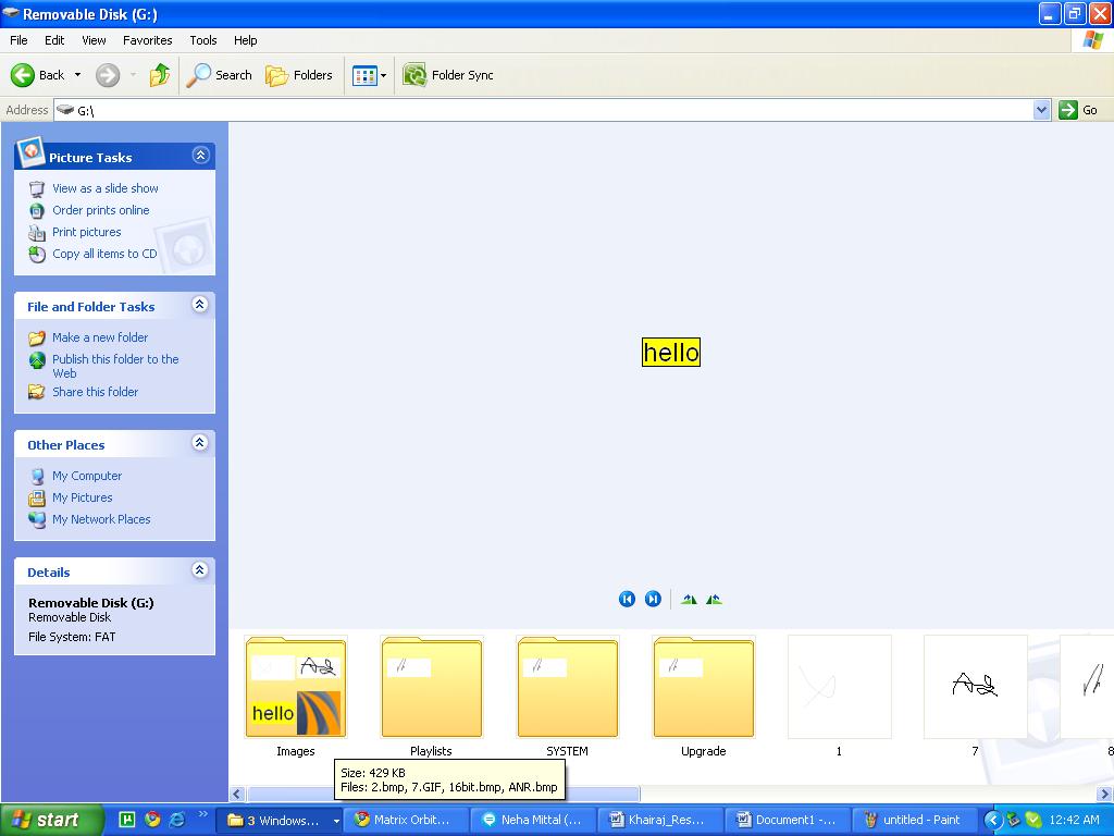

Also on SD card I see the files Playlists SYSTEM Upgrade autorun changelog only should any other files be present there?? I have pasted my 7.gif there only or should I use any specific location to upload the image??Ashok wrote:Ashok wrote:Thanks Clark , I have tried with your code but still this is not working and not displaying anything on TFT.Clark wrote:Hi Ashok,
A quick note, I saved my code file as a .txt so I could upload it here, be sure to save it as a .gsf before trying to load it into GTT Tools.

- GTT memory pic
- sdcardpic.jpg (77.39 KiB) Viewed 17352 times
Ashok Gupta

- GTT memory pic
Ashok Gupta
Clark somehow pic is still showing in outbox there so I posted it here please see the pic and tell me what can be doneAshok wrote:Ashok wrote:Also on SD card I see the files Playlists SYSTEM Upgrade autorun changelog only should any other files be present there?? I have pasted my 7.gif there only or should I use any specific location to upload the image??Ashok wrote:
