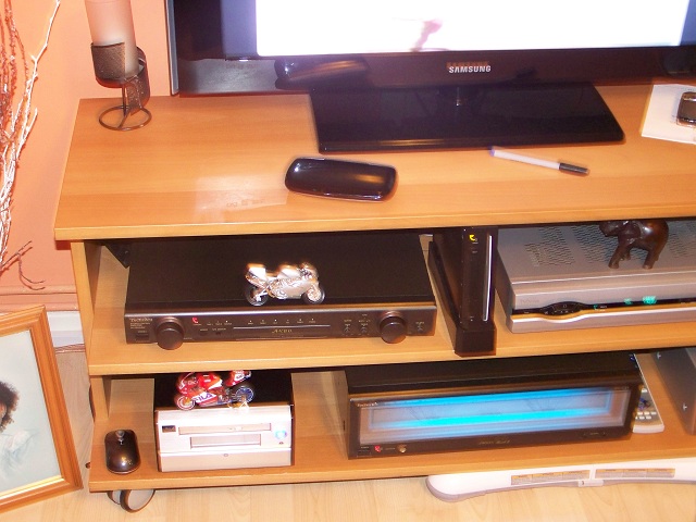

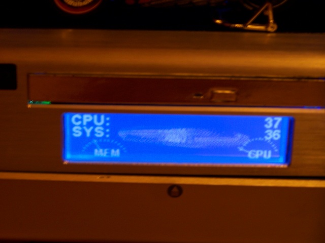

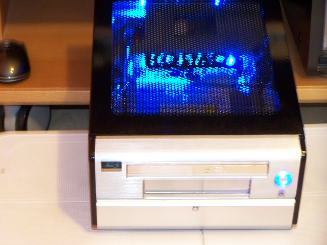

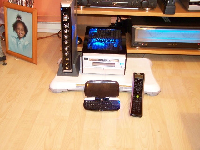

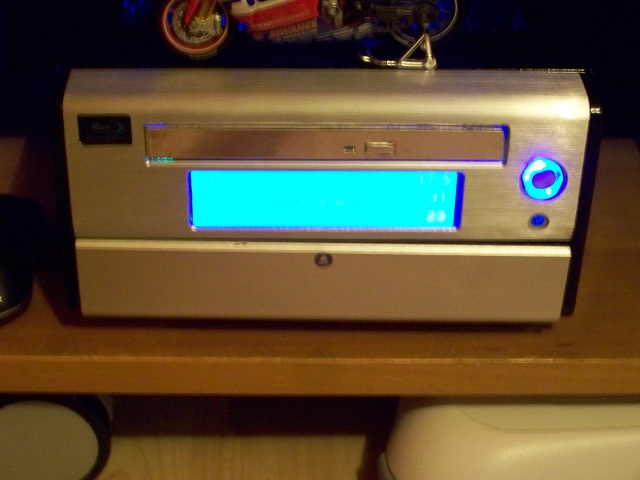

The other half set a challenge .She wanted a compact media centre capable of playing blu-ray discs & hd.mkv films with good sound quality for Christmas. since I had an xfi elite pro & a Noah mini itx case already i chose to begin there.The case has been modified to fit the big SoundBlaster soundcard & the matrix orbital typhoon.
the most tricky was removing the old op amp chip from soundcard(smt) for a better one.we do not have 5.1 but the xfi external bot downmix 5.1 sound from virgin hd box into 4 channel so pc is acting as a dolby digital decoder as well.She is very happy

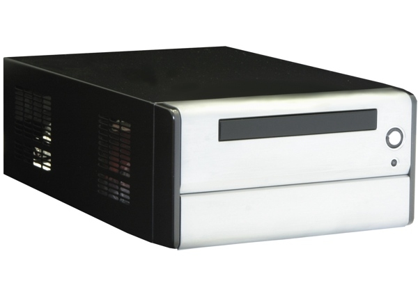

case before mod
case before mod
