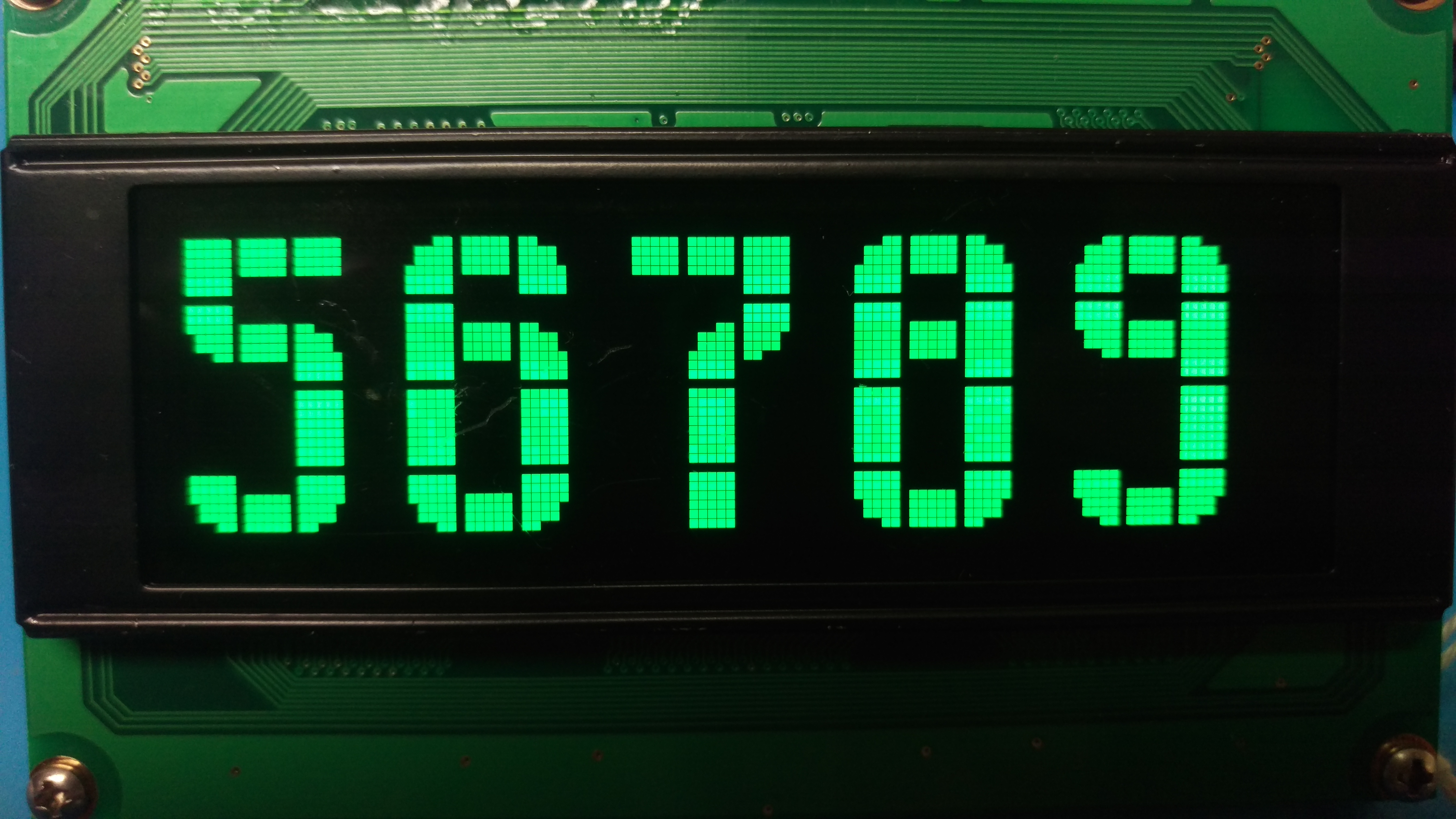

But in fact, I could not find a single pic showing the large digits so I have no idea what they should look like, haha.
Am I close? :)

Re: LK204-25_PC and his screen
Hi Ultraspider,
Your replication is pretty on the spot.
I've drawn the large digits from 0-9 on one of our newer displays so you can see how each digit should look.
Hopefully this helps you sort out the rest of the digits.
ultraspider
Posts: 41
Joined: Sun Dec 02, 2001 4:00 pm
Location: belgium
Post by ultraspider »
Thanks again Daniel.
I have everything I need now. Now back to my project.
