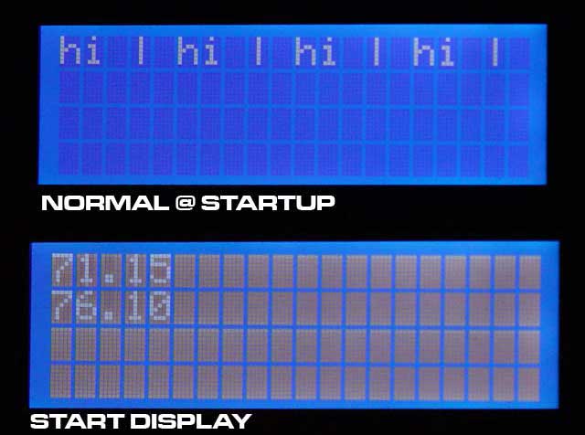

When I start my computer the display lights up with perfect contrast but when I test , active preview or run the display all of the blocks light up slightly.
no matter how I adjust the contrast and backlight in testing it never reproduces the look when The unit is powered up. here is a picture of the hi startup screen and when I start the display 2 temp readings. It works displaying the temp but as you can see all the squares light up.
Also once I start the display I have to turn it off before it goes back to normal.

thanks I fixed it
Thanks tom contacted me and had me turn down my contrast since its a white on blue display. It worked great I knew this happened before and i fixed it myself. I just dont have the screws yet to mount it so it sat on the shelf. I have a laser engraver and I plan on laser cutting a slot in the window for my lcd4041 also to run with my mx412. I may add 3 lcd4041's since I got a great deal on 3 at ebay. anytway thanks.

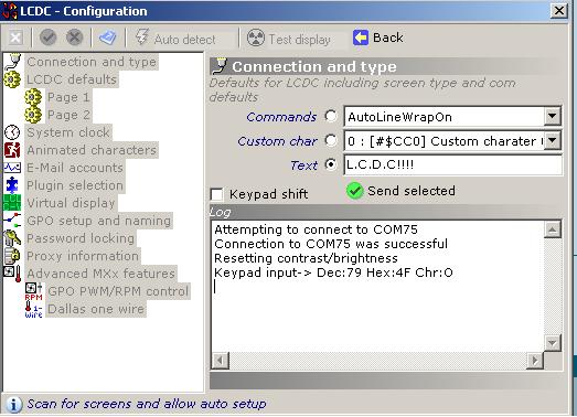

To start you must find out what characters your keys generate. To find this information, you must go into the test/configuration section. When you go into the "test display" section the log will show you what character is generated, once you press a key. The picture below will illustrate this in more detail.

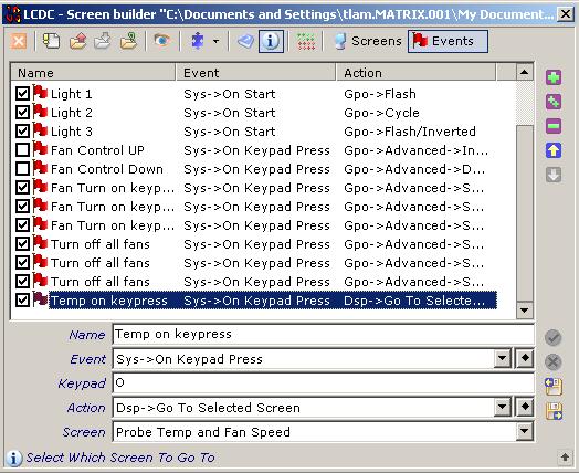

You will then need to make an event to jump to the specific screen. I have also inserted a picture to illustrate these details.
