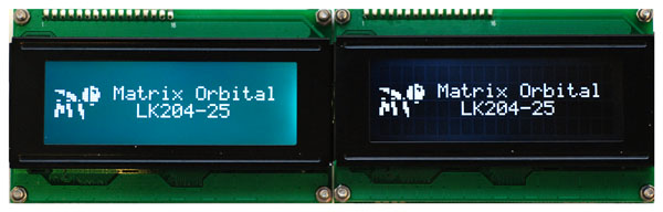

FSTN has special retardation films added with the rear polarizer to make up for the interfering color of STN so that a true color can be seen. Different angles of the film can create more options, i.e. positive, white/gray background with black font; negative, black background with gray/white font.
Matrix Orbital displays use FSTN. This clear film adds superior clarity in the displays.
FSTN vs FFSTN negative White LED display
FSTN vs FFSTN
FSTN vs FFSTN
