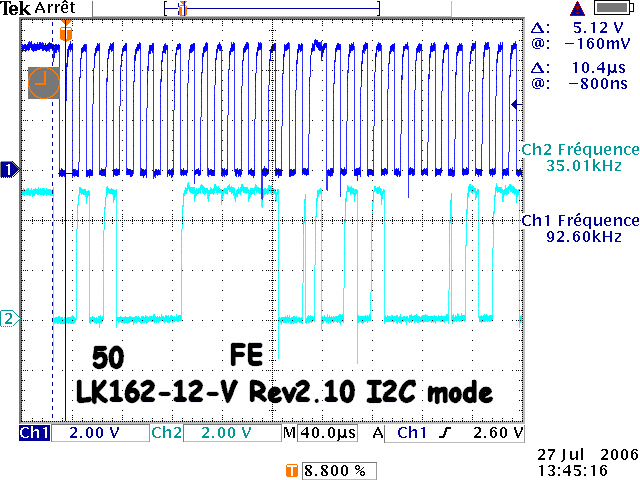

Thanks for the idea ... alas, 'tis NoGo. Adding a jumper to pins5/6 on the keypad interface = no change. Attached is a screen capture of the SCL and SDA lines (the attachment is a zipped PDF). Anything pop out? I also reversed the SCL and SDA connections, just in case the pinouts were incorrect. As I wrote earlier, this is my first expedition into I2C land ... it is a frustrating journey this week.

Hello BeerMug,
After looking at the attached file, I can see that you are actually sending address 0xA0. Note that 0x50 is b'01010000' which is not what we see on the picture.
I am attaching a file that should show how the I2C transaction should go. Only look at the '50' for now and note when it starts. The first '1' on the SDA should line up with the second pulse of the SCL.

Wonderful !! The program apparently shifts the address bits (rlf) once before transmitting, i.e. converts to a 7-bit address. That was a tad confusing to me, the neophyte, but I accepted their description. I presumed that the 7-bit address was somehow different from the normal 8-bit decoding... learn something new every day (of course, being dumber than a case of rusty anvils makes it easy to be exposed to something new every day...). I'll kill that initial rlf instruction and see what happens.
Again, thanks so very much for your time, your patience, and your support.
