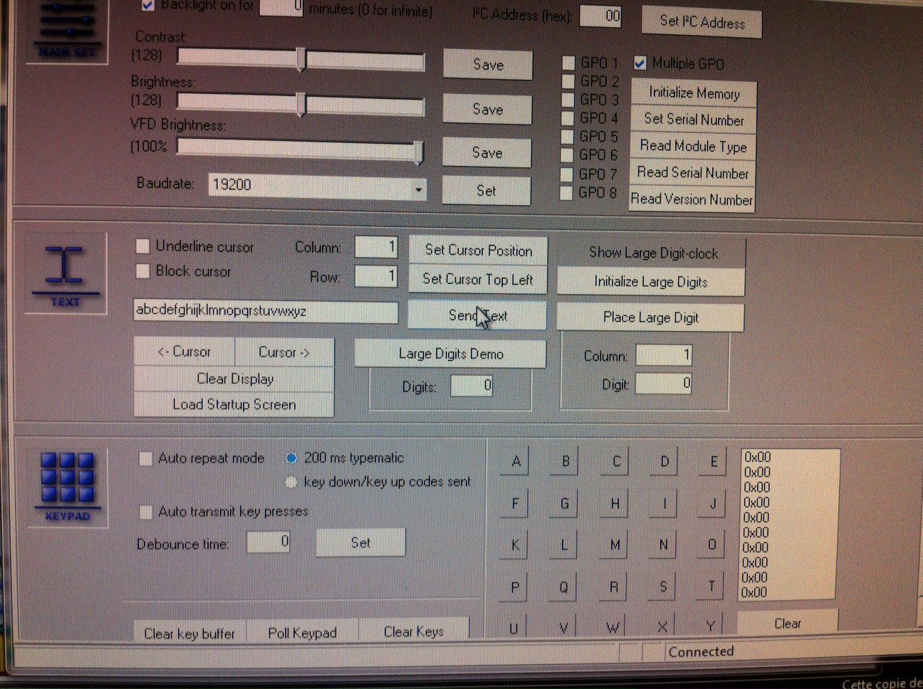

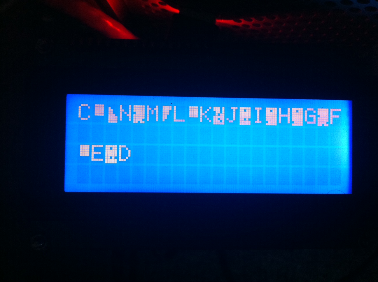

i follow your recommandations, here is the result. I tried to send the alphabet, i attached photos.
Do you had similar cases ?

Hi Pacopad,
Unfortunately I have tried but can not replicate the issue you are having with your display.
You could send the display in for further analysis and repair. Although the display is not likely still under warranty. Which will leave you responsible for the shipping both way, labor cost and cost of any parts needed for repair. Which could be expensive.
Another option is a newer version of the display.
