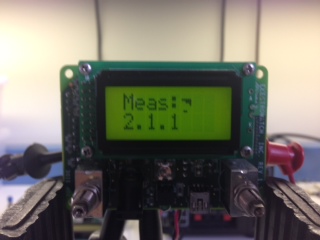

Thanks for your reply. The random character always seems to be the same character (see attached photos). The display seems to properly execute all commands sent to it.
I have attached three photos. The first shows the random character after a colon.......this may occur in one our of every 5 power up sequences.

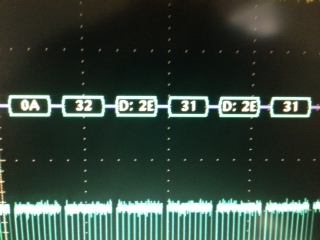

The next photo is the data stream associated with the first photo. The random character is clearly not being sent to the display.
I2C data stream.JPG (34.79 KiB) Viewed 8192 times

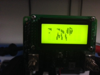

The third photo shows the same random character occasionally appearing on the MO power up screen.
Char appears after two secs on MO screen.JPG (24.17 KiB) Viewed 8192 times

I have replicated the random character that you are getting on your display. I get it two seconds after I send data to my display without sending a "Stop Condition" at the end of the data.
With that being said this may be the cause in your case. Please be sure to have a "Start Condition" sent to the display before the data is sent to it and a "Stop Condition" at the end of the data or commands.
