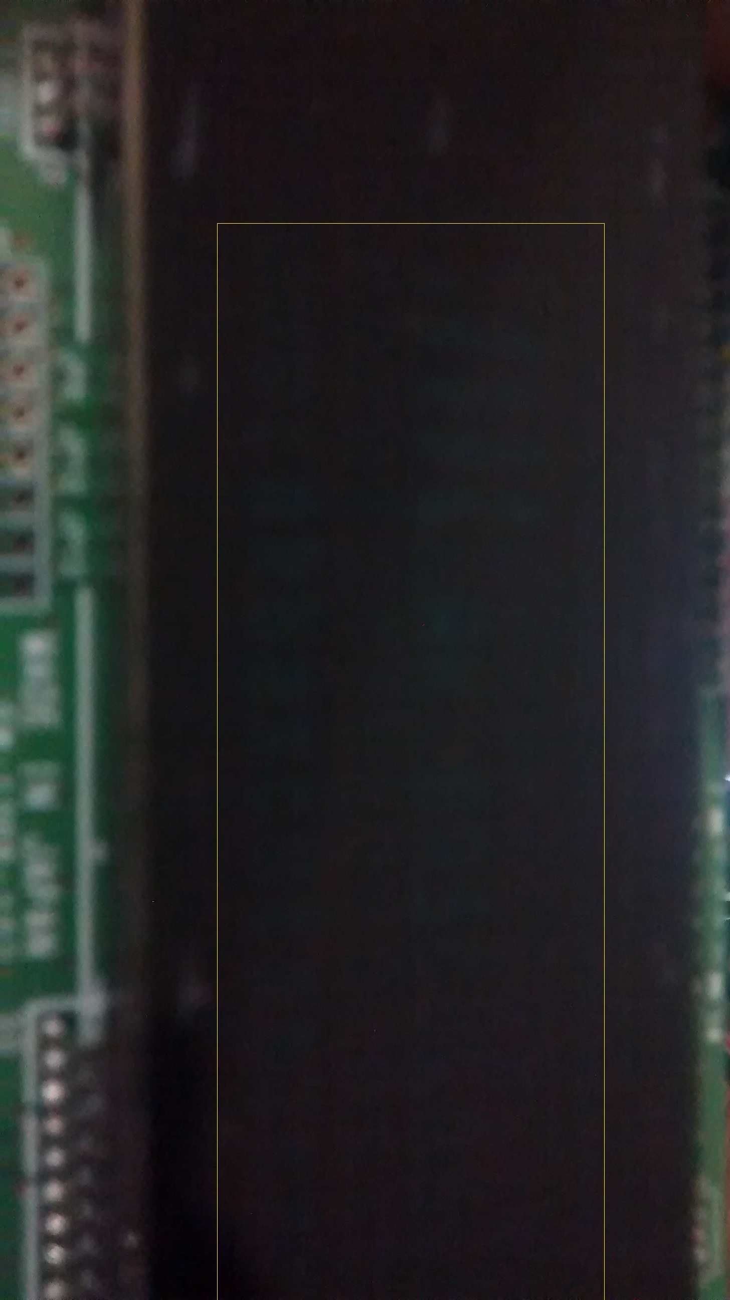

VFD Display was working just fine, now has very low bright, almost visible at no light condition, y make the manual override but it was the same.
The comunication its working, i send command for set vfd brightness and it works, but the maximun brightness (0) its to low.
VK204-25 ver3.0
Thanks.
VFD very low bright
VFD very low bright

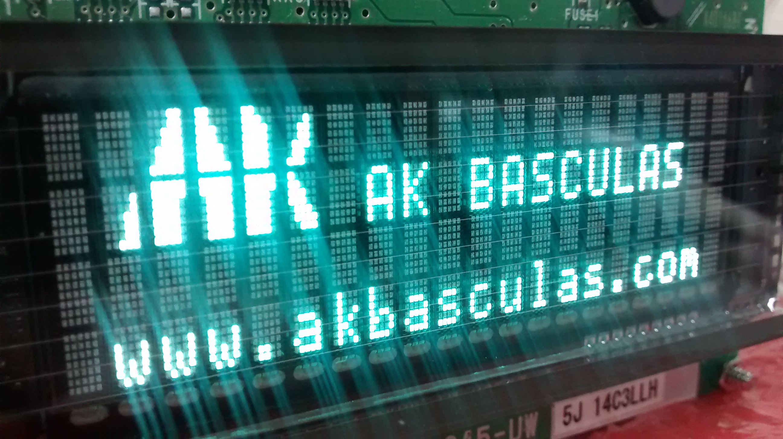

- same display working fine
- IMG_20140926_101752008.jpg (1.26 MiB) Viewed 5667 times
- Low bright
- IMG_20141016_193624651.jpg (720.13 KiB) Viewed 5667 times
Re: VFD very low bright
Hello Tawyxxz,
The manual override procedure will force the brightness setting of your VK204-25 back to the default value. I see you have also confirmed the unit responds to manual brightness commands.
Unfortunately, this unit may be suffering from a hardware fault. If you could please provide the serial number of the unit to me at tclark@matrixorbital.ca we can explore options for an RMA.
The serial number will be in black ink on the back of the unit in the form ##M##-####.
