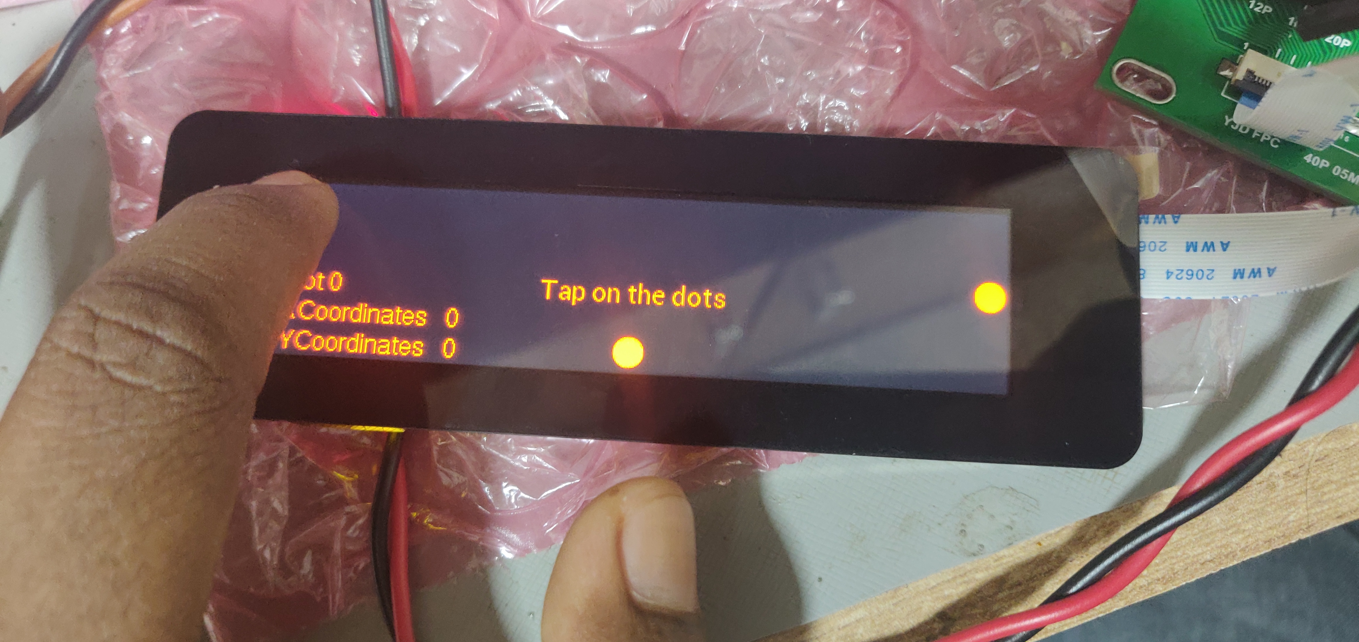

Now I am working with your capacitive touch screen display. I used your MO_Calibrate code. Because I don't have SD card option. I have modified few things in your MO_Calibrate code. But the touch functions are never working. Herewith I have attached my full project code also. Please let me know, is there any limitation for your display board?. Please help me.

- Posts: 247
Re: EVE2-38G question about of the touch calibration
Hi Suresh,
It looks like your photo didn't upload properly. Please try uploading the photo again.
Also, are you sure you are using a capacitive touch screen? In your other posts, it looks like you are using a resistive touch screen.

Hi Daniel,
Thanks for your reply. I uploaded new photo. Please go through my attachments. Yes, Daniel. I bought two types of display. I bought resistive and capacitive also. Currently I worked with your resistive display. But I have to improve touch accuracy. I will handle that issue. If I cannot fix the issue, I will ask you. As of now I am working with capacitive touch screen display. Yesterday I got the above issue. Means that, the capacitive touch is never working. I have attached my code and snapshot also. If you need more explanation, please go with my previous reply in this same post. I explained that how i used my calibrator code.

- Posts: 247
Hi Suresh,
Thank you for clarifying.
Could you try replacing the following lines in MO_Calibrate:
with
Then give it a shot.
//Ft_Gpu_Hal_WrMemFromFlash(phost,RAM_G,TOUCH_DATA_U8,sizeof(TOUCH_DATA_U8));
Ft_Gpu_Hal_WrMemFromFlash(phost,RAM_CMD,TOUCH_DATA_U8,sizeof(TOUCH_DATA_U8));
Gpu_Hal_WrCmdBuf(phost, CTOUCH_CONFIG_DATA_G911, TOUCH_DATA_LEN);
- Posts: 9
- Joined: Tue Jul 02, 2019 9:57 pm
Hi Daniel,
Awesome. It's working well. Thank you so much for your support.
