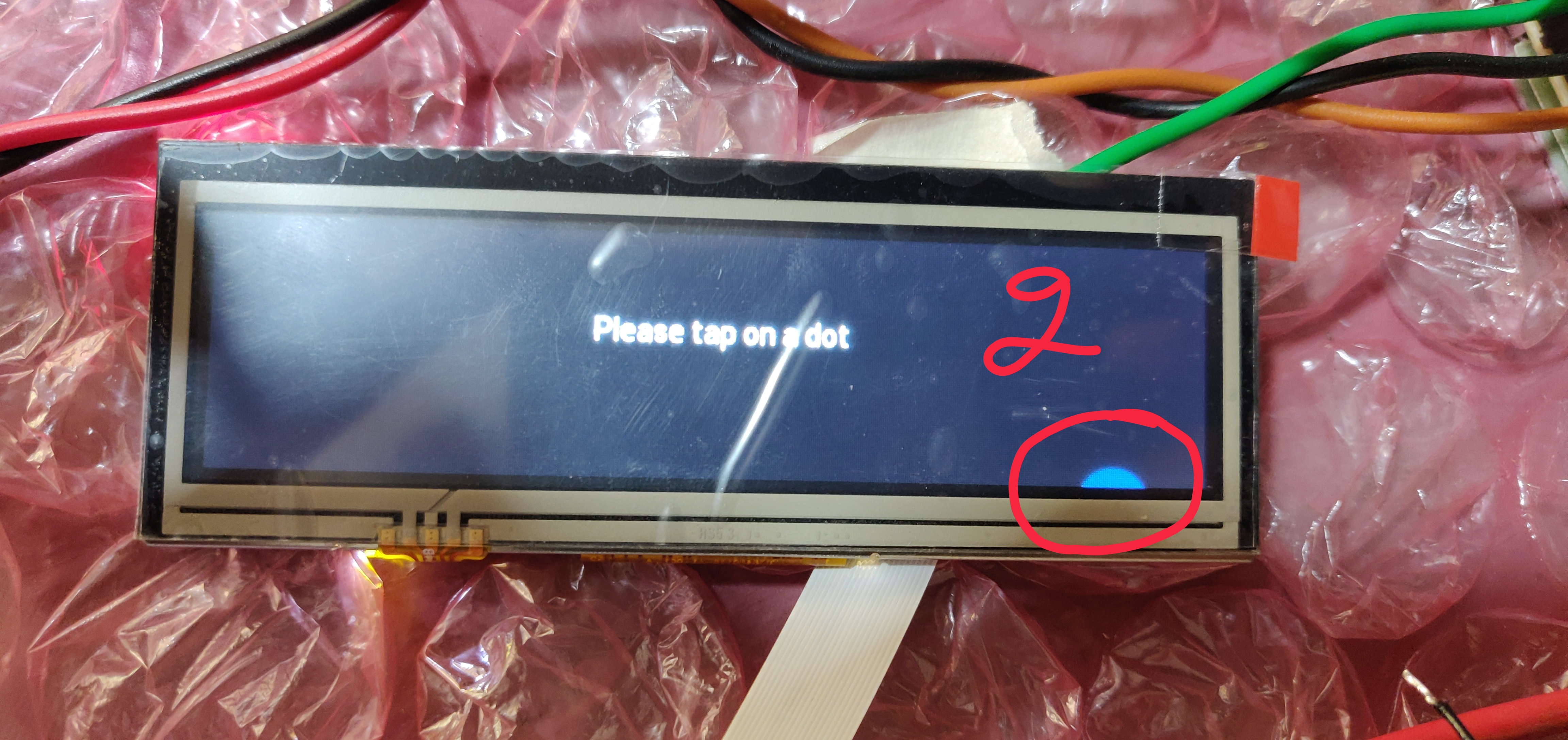

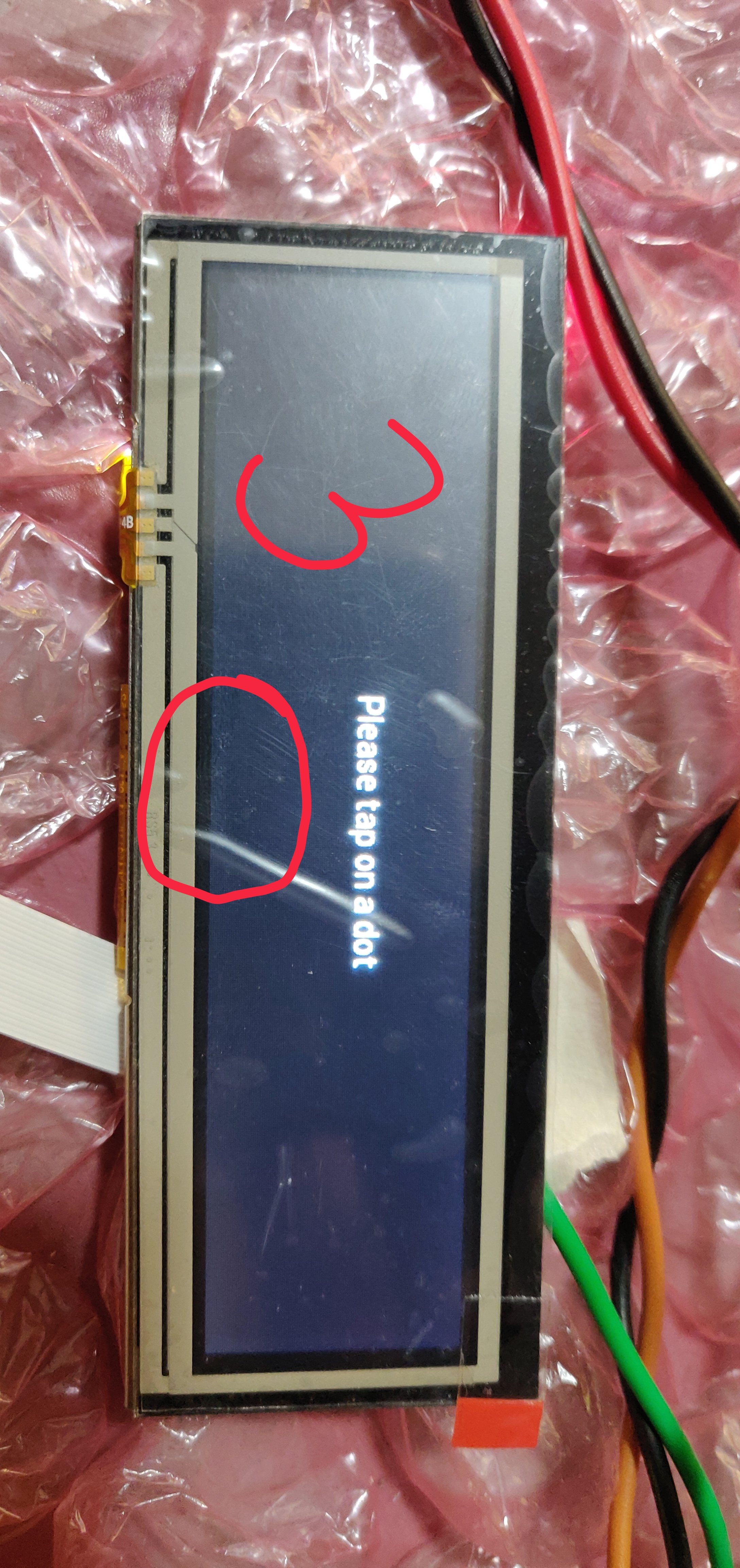

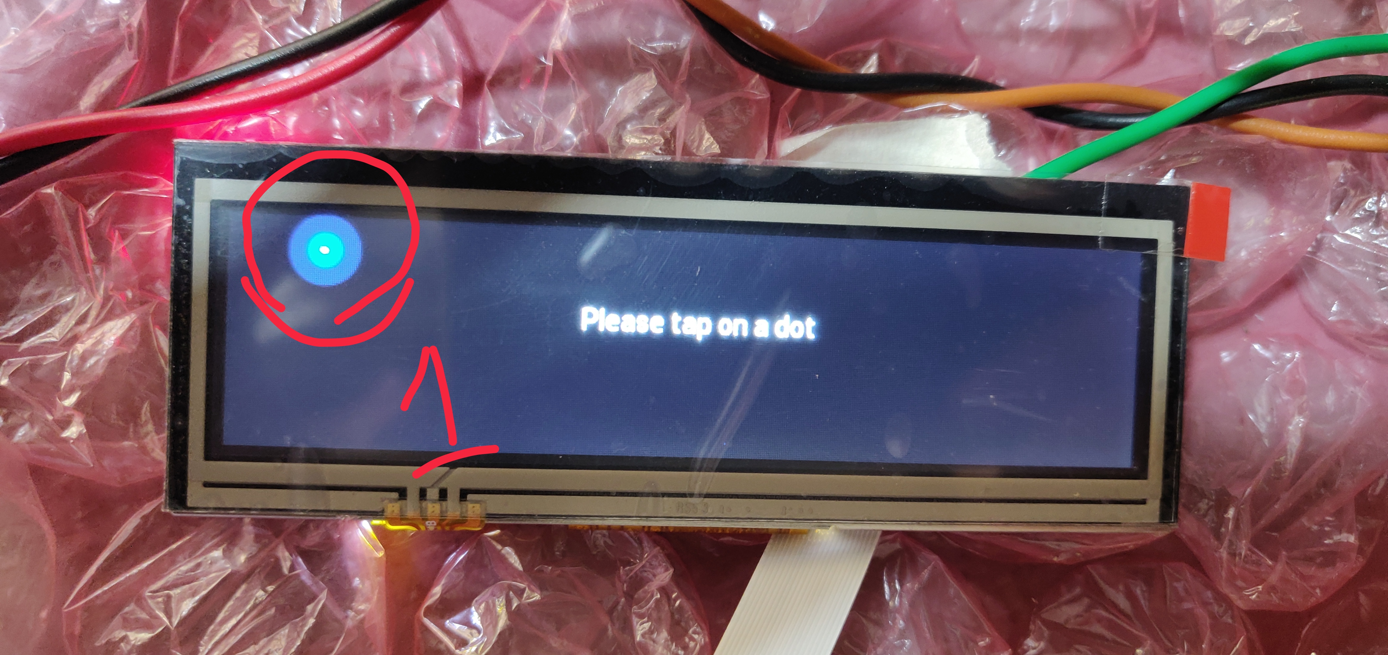

This is Suresh from Chennai,India. Recently I bought two displays from your side (EVE2-38A-BLH-TPR & EVE2-38G-BLH-TPC ). As now I started with resistive type display. Basically its is working well. But I found the following issues.
1) When I have run calibration thread. I have found axis issue in my display. That means dots are not appearing correct place. I have attached my snapshots which I have taken during calibration processing time.

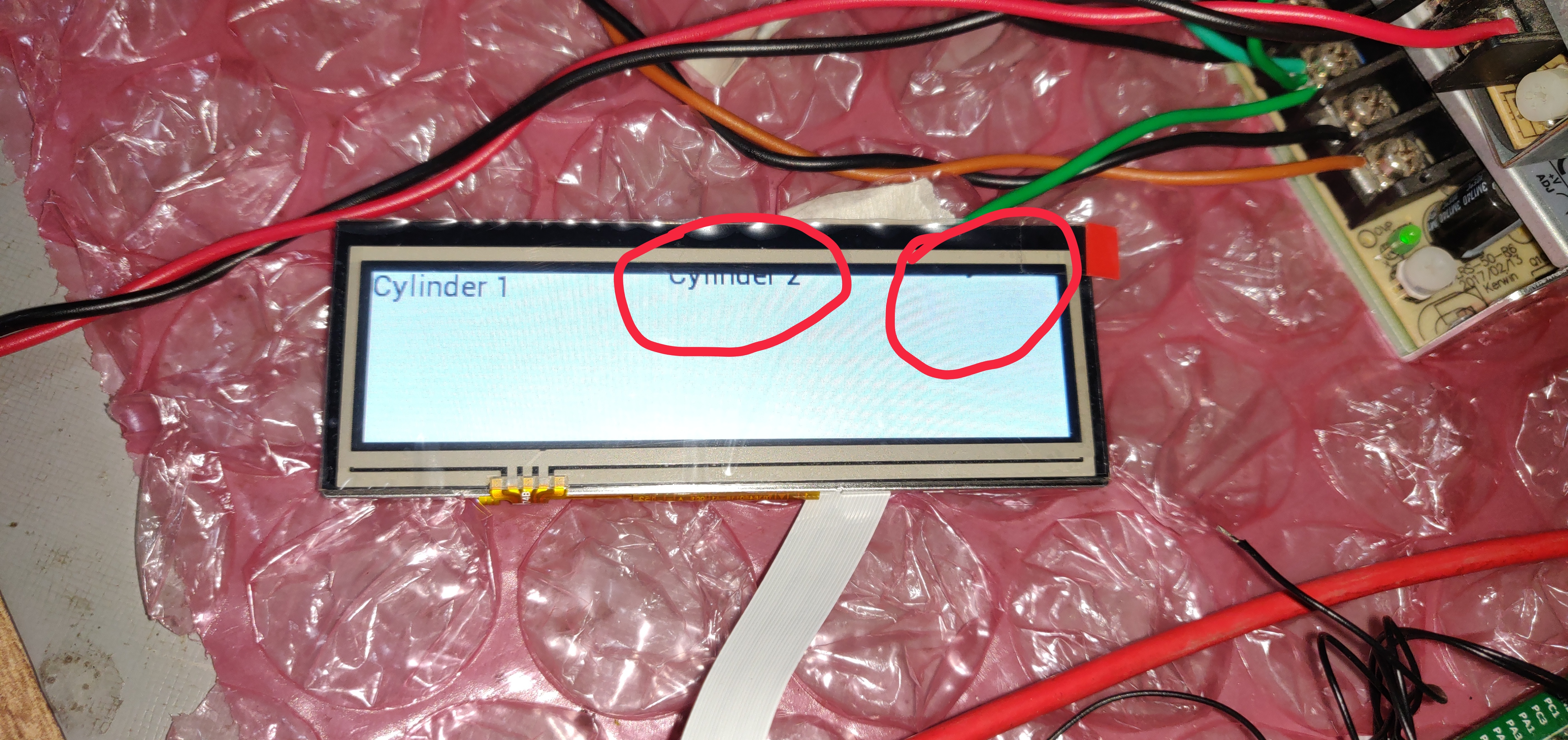

2)I am facing issue on my Y axis also. I am printing "Cylinder 1", "Cylinder 2" and "Cylinder 3" for the following axis (0,20) ,(200,10) and (400,0) respectively. But the above last two axis are not appearing well. I have attached my code screen shot.

Ft_Gpu_CoCmd_Text(phost,0,20, 28, OPT_CENTERY, "Cylinder 1");
Ft_Gpu_CoCmd_Text(phost,200, 10, 28, OPT_CENTERY, "Cylinder 2");
Ft_Gpu_CoCmd_Text(phost,400, 0, 28, OPT_CENTERY, "Cylinder 3");

- Third dot is not appearing for calibration processing
- IMG_20190703_091743__01.jpg (2.24 MiB) Viewed 44881 times
- IMG_20190703_091656__01.jpg (2.25 MiB) Viewed 44881 times
- IMG_20190703_091648__01.jpg (2.25 MiB) Viewed 44881 times

1) The EV2-38A is a little bit different from our other displays, as it is a 4.3" display cut in half. This means that it needs to use the 4.3" timing data in order to operate properly. Due to this, the FT81X's calibration command won't operate properly. That said, we have made a calibration code example that you can use to calibrate your display.
2) Due to how the display is cut, you will need to offset all of your assets and widgets by 10 pixels. So, if you want an asset to appear at (0,0), you will have to place it at (0,10) on your EVE2-38A.
3) I believe this is due to the lack of proper calibration.

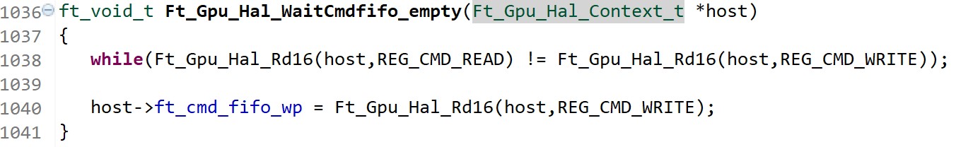

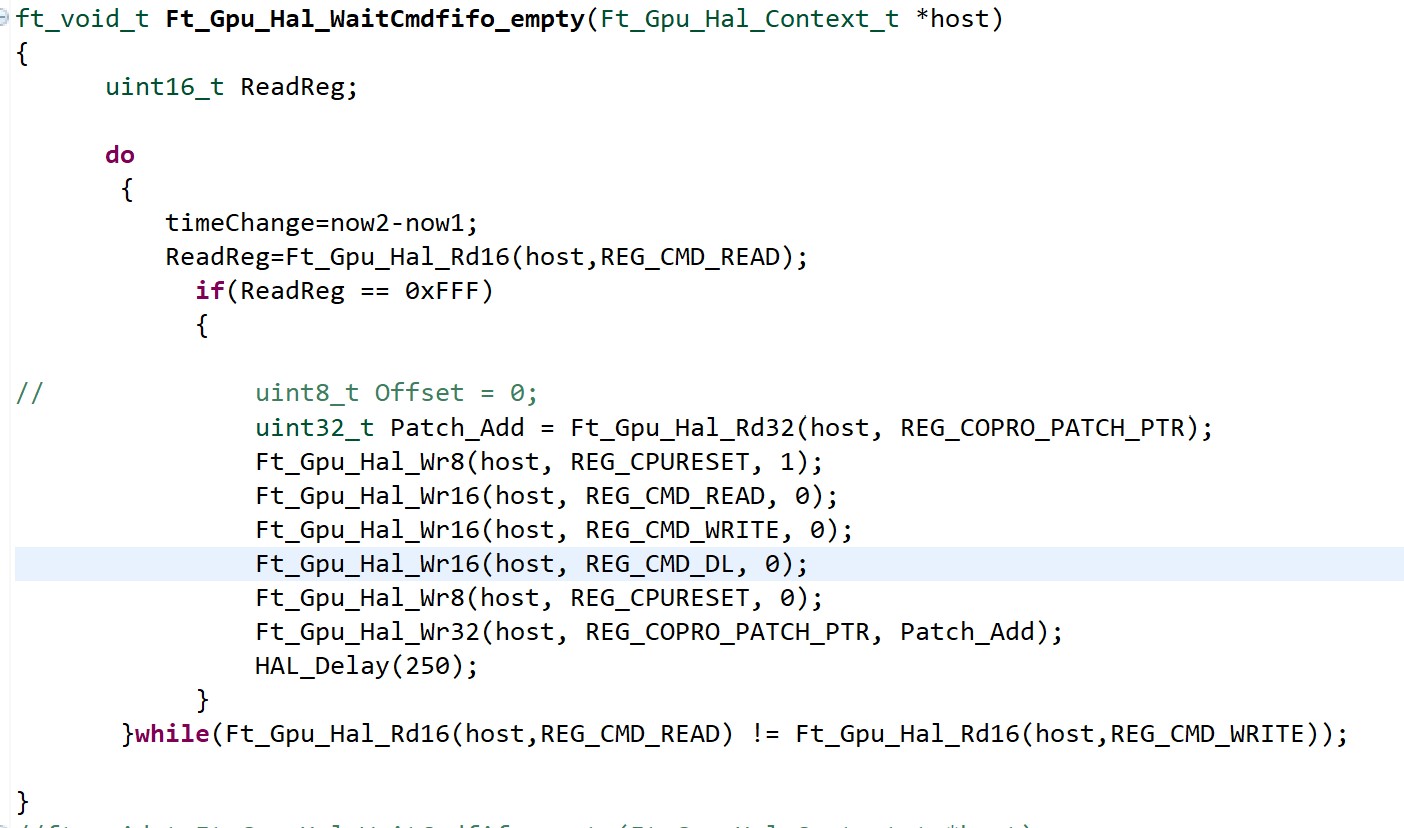

But during our final full load test(24*7) , we are facing hanging issue in the "Ft_Gpu_Hal_WaitCmdfifo_empty" function.In that situation ,"REG_CMD_READ" register will not be equal to "REG_CMD_WRITE" register. So the Micro-controller will not come out from this "while" loop. Please find the below image for my initial code.
After that i found the Test code in your GITGUB (https://github.com/MatrixOrbital/Basic- ... Eve2_81x.c). Then i changed my code with reference of your sample code . Please find the below image for my modified code.But we have not yet fix this hanging issue. You used extra two registers which are "RAM_ERR_REPORT" and "REG_COPRO_PATCH_PTR ". But they are not declared in datasheet/user manual. So i could't proceed without clear understanding of usage of these 2 register. Please help me to solve the "display hang" issue by explaining this.
I have uploaded my project code also. If you need please refer my entire code and suggest me to solve the issue.
