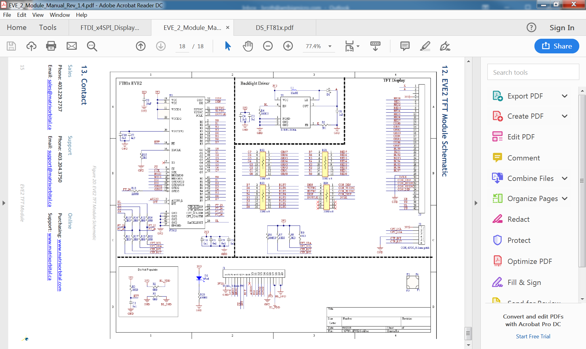

I have a EVE2-43A-BLM-TPN connected to our FPGA platform with Ambiq Micros MSPI quad master controller. Attached is the schematic connection through a 1.8V to 3.3V level shifter to the 20 pin FPC connector on J5. We cannot get any response from the FT812 on the EVE2 module when we try to read the electronic ID at 0xC0000-0xC0003. The MISO pin just stays low like nobody is home. RESET_n is high and Power is good. Any ideas?

- Shows no external xtal/clock so we set to internal(contradictory to the programmers's guide)
- EVE2_sch.png (335.66 KiB) Viewed 7475 times

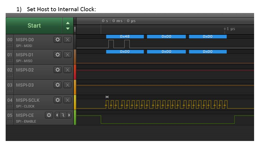

- 1) Set Host to Internal Clock: (schematic shows no external clock)
- init_1.png (177.25 KiB) Viewed 7475 times

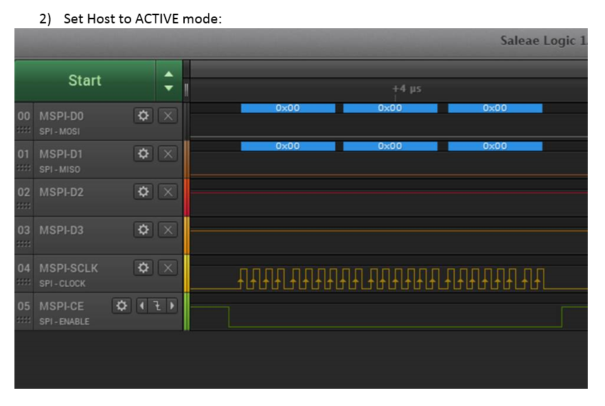

- 2) Set Host to ACTIVE mode:

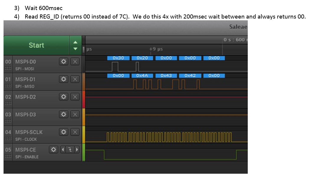

4) Read REG_ID (returns 00 instead of 7C). We do this 4x with 200msec wait between and always returns 00. - init_3-4.png (244.18 KiB) Viewed 7475 times

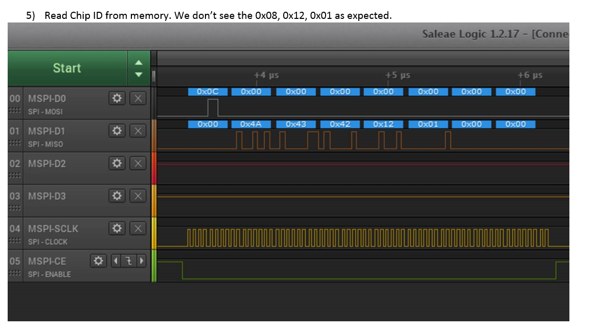

- 5) Read Chip ID from memory. We don’t see the 0x08, 0x12, 0x01 as expected.
- init_5.png (320.58 KiB) Viewed 7475 times

After slowing the SPI clock down below 11Mhz for initialization we have a backlight and are reading the DEV_ID correctly!
