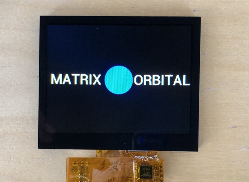

This code when executed will display MATRIX ORBITAL text and a circle switching between blue and red.
This code will illustrate:
  • EVE initilization
  • Set colour
  • Draw circle
  • Write text

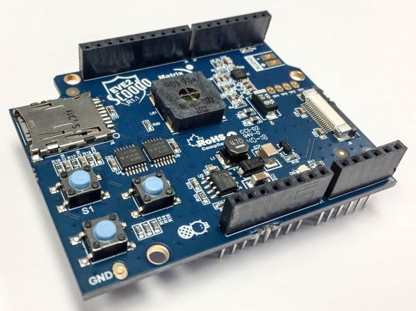

Scoodo EVE TFT SHIELD for Arduino
https://www.matrixorbital.com/eve2-shield

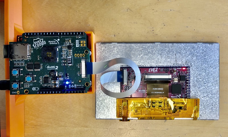

EVE SPI TFT connected to a Scoodo SHIELD
