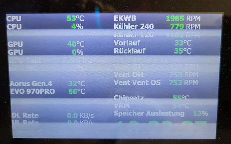

I am using the EVE2 50G display in combination with the EVE2-USB2SPI-KIT-A on my Windows PC.
The problem is as follows.
The display shows horizontal waves that move from the bottom to the top.

- horizontal waves that move from bottom to top
- EVE2-50G-BLM-TPC.jpg (80.33 KiB) Viewed 2920 times

Hello Eddi,
Are you able to test out the power coming from the USB2SPI bridge?
Can you please check it using a scope?
Can you also try supplying external power via the barrel jack? Center positive, 5V-12V 1A if you have it.
