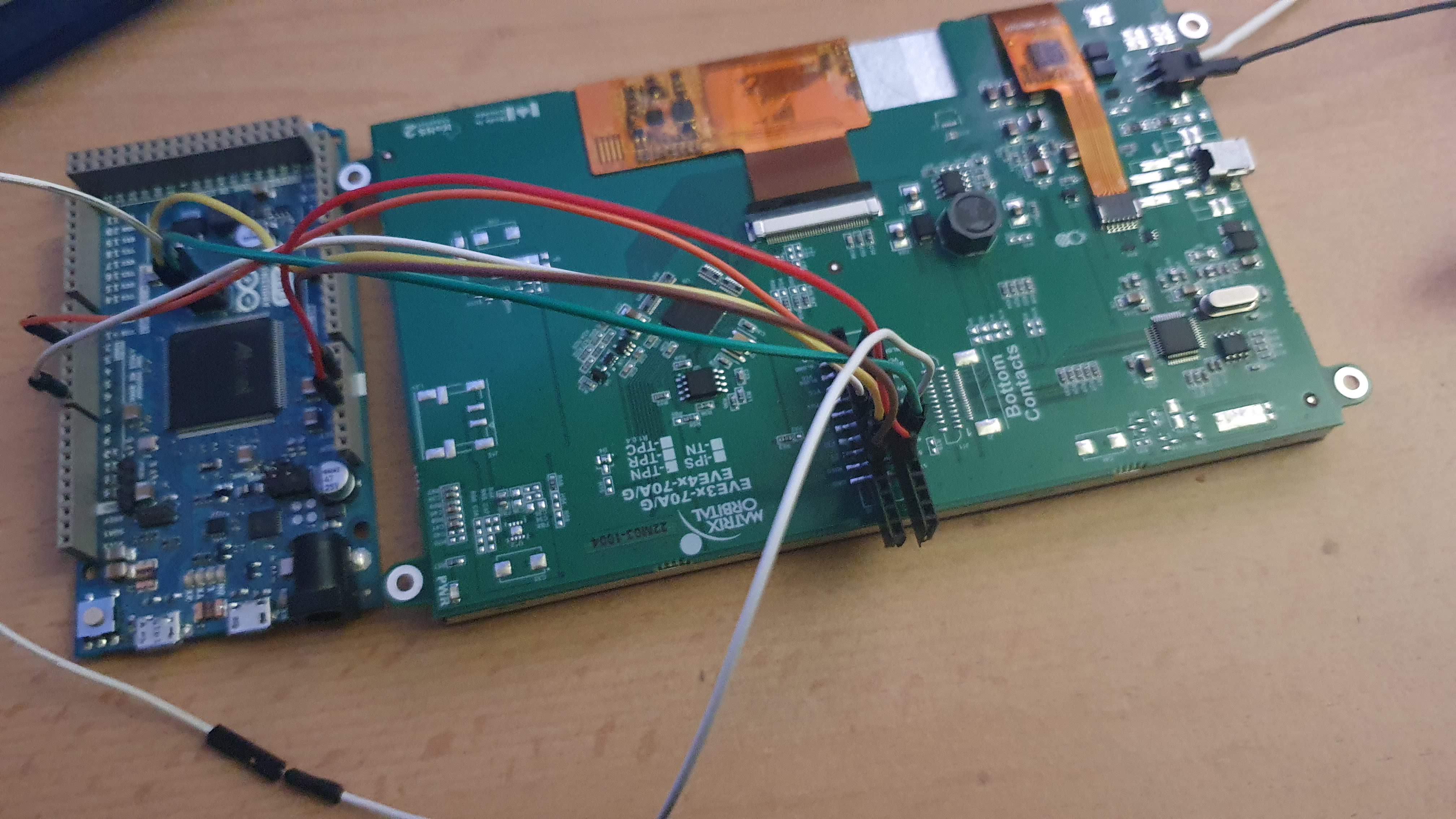

I recently bought a Matrix Orbital display: EVE4x-70A-IPS-BLH-TPC-F128-USB ( https://www.matrixorbital.com/eve4x-70a ... h=eve4-70a ) and i can not set it up to work with my Arduino Due ( for testing ) over SPI.
The board looks to be fine, i ran the precompiled (EVE4-101.exe) in a windows VM ( because the code after compilation it refused to run on my computer ) with the onboard USB attached + feeding 7V over the black connector. The Logo was dispalyed and touch also works.
Currently i try to set it up with an Arduino Due. The pin headers werent soldered in my board, so i soldered in some of them and connected the following:
- GND - GND
- RST - Pin7
- CS - Pin3
- MOSI/MISO/SCK to the Due SPI header
(I found in another topic that the black connectors VCC and VCC pins are tied together so i didnt connected to 3v3 but i tried that also )
Currently im trying a simple sketch which only tries to boot up the display and read back the board id but im stuck here ( all other driver libraries where also stuck in this part ). It just contantly reads back 0x00 and never reads 0x7c which it should according to the documentation.
I checked the connections also checked the SPI pins with a scope and i could confirm indeed the data is sent but nothing comes back on MISO. The current consumption jumps a few 10mA when reset/cs is asserted/deasserted so it seems the headers are also fine on my board.
I already wrote to the support too because i ran out of ideas, hope that somebody can help here.
