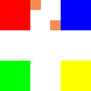

I have a nine slice image and file setup but when I tried removing the HSCALE keyword from the file it doesn't have any effect. The top middle portion always stretches instead of repeating when displayed using the display nine-slice command FE 91.
I also tried experimenting with different TRANS-R, TRANS-G, and TRANS-B value but did not see any difference.
Is there a particular scenario in which these apply?

Test files are attached. From the documentation, leaving out HSCALE should make the top center with orange boxes tile instead of stretching and white should be transparent.

What you are observing is correct.
There is no implementation of tiling for the 9slices currently.
I will see what I can do to request to have this implemented.
