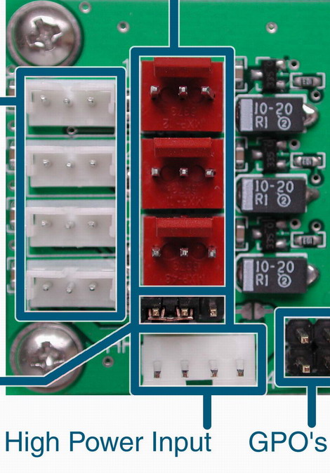

Does your display light up when you plug in an unmodified floppy power cable?

No idea. it's A USB unit. where do i plug in a floppy cable?
Every usb unit has an input to power up the fan headers. The picture below describes the the connector for the floppy power cable input as High Power Input.
senor_fulff
Posts: 6
Joined: Tue Nov 22, 2005 8:00 pm
Post by senor_fulff »
Yippee!!!
That got it working but it is far too bright now. Will try fiddling with LCDC to get it working right.
Thank-you for your time it is very much appreciated!!
