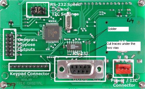

If you have a 20x4 VFD with a keypad input, then you must have the VK204-25. You can try the following modifications to change the unit to TTL communications.
TTL communications will be on the same lines as the RS-232 lines. TTL and RS-232 is almost the same except for they are different voltage levels. In RS-232 levels -12V indicates a high, and +12V indicates a low. TTL communications 5V is a high, and 0V is a low. The main reason why people use RS-232 communications is that you can communicate over long distances without any interference because of the high voltage swing. By doing the modifications, we are bypassing the RS-232 chip.

Ok, so I cut the traces, and then bridge the two gaps in those two solder pads where it says "solder", and then I'll have TTL levels on the DB-9 where I would have originally had RS232 (ie, the receive and transmit are on the same pins as the RS232 Rx/Tx)?
Is it possible to power the display over the DB9 connector, too, so I can just have a single plug? It seems like PC serial ports have a +5V and ground pin already...
Yes, the Rx and Tx pins will remain in the same orientation for TTL as they were for RS232. You can apply 5 Volts ONLY via the DB9. CAUTION: Voltage input via the DB9 is not regulated, therefore you must apply 5 Volts only. To apply voltage via the DB9 connector you must solder the "solder jump" located just below the DB9. Please let me know if a picture is required of the solder jump.
