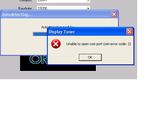

I'm trying to communicate with my LK162-12-WB LCD via RS-232 with my PC and uProject. When I try to communicate with COM1 at a Baud Rate of 19,200 I get an pop-up error message. I took a screenshot and have attached it to this post. Has anyone had any issues like this, and if so how did you fix it?! Any help will be greatly appreciated!
Carl
uProject error
uProject error
- uProjectError.JPG (18.98 KiB) Viewed 4621 times

Hi combatc2,
The problem that you are noticing is the autodetect function giving you an error.... The autodetect does not work on uProject and to the best of my knowledge this software is not being supported by the author anymore.
However, all you will need to do, in order to get past this screen, is to manually select the com port, and then select the baud rate that your display is at (the default is 19200).
jon
