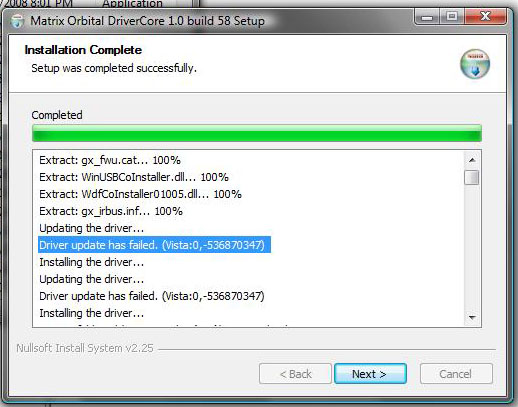

Hi, I just got the GX installed and am trying to install the Drivercore software. It will not install the driver correctly using the installer on Vista 64 bit. I have to go to the device manager and manually get the driver to install. I then try to run the LCD Defaults Configuration Utility and no devices are found. What am I doing wrong?
I also installed the LCD studio software and it actually posted the welcome message on the display but then I can't get anything else to display..
Please help!

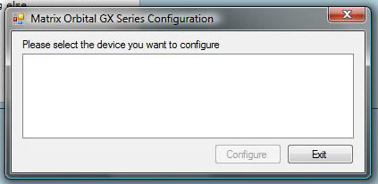

By default when the defaults utility starts all other applications should let go of the device only then will it show up in there. but somehow this doesn't seem to function on your system.
What I want to you to try.
1) Right click on my computer, click manage and head over to services
2) Stop the drivercore service.
3) Now try the gx defaults application.
Does it work then?

I did notice that as soon as I started the defaults utility, LCDInfo stopped working. Btw, what does LCDInfo do?
I restarted the service and DriverCore Manager (drivercoretray) no longer sees the display. To get the display back, I have to uninstall/reinstall the driver.

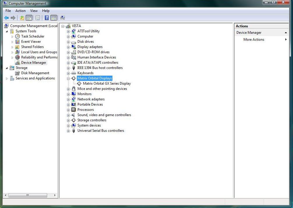

I did this part since the installer did not install the driver.
1) The driver is loaded, the driver we chose is the stock microsoft winusb driver we opted for that so we did not had to write our own driver and cause nasty blue screens.
You can verify this is loaded correctly when the display shows up under Matrix Orbital displays in your device manager.
Confirmed, the driver is appearing correctly.

I cannot get GX Defaults to show the display. I also stopped DriverCore service which resulted in LCDinfo stopping. I have a G15 keyboard, would it be conflicting with the display? Also, in Vista 64, I have DEP turned off and also UAT is off.
