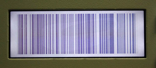

Sometimes stripes like in attached photo appear on my GLK19264 instead of Matrix Orbital logo when powered on. After next power off / on it works normally. Anybody experienced something like this?
- matrix_orbital_stripes_1m.jpg (41.07 KiB) Viewed 3869 times
Hi Ubik,
The lines noted in the image provided are typically the result of starting the unit with dirty or noisy power. Investigate your power supply to ensure that it is stable and consider switching the display independently of your supply to remove any spikes during the initial power up.
~Troy
