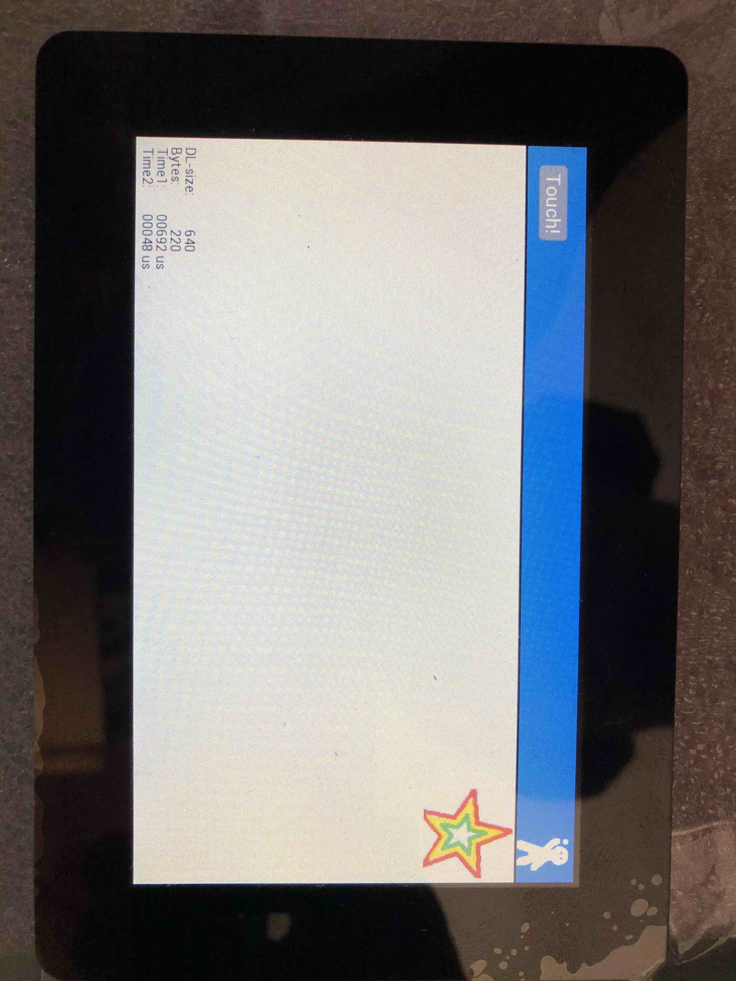

Re: Arduino EVE2 / EVE3 Examples
Hey Rudolph,
Opened, compile, and downloaded the Arduino project with zero code modifications and got what appears to be a valid screen!? (image attached). Hardware is Arduino Uno, Matrix Orbital EVE2 Scoodo Shield and 5" 800x480 EVE2 Display.
I'm currently digging through the code and going to try a few more things, but is this what I should expect to see based on your work? The star is rotating in the upper left corner and I'm able to touch the 'Touch!' button and observer it press and depress. DL size changes between 640 and 784 between presses. Times 1 and 2 are also flickering (I'm guessing they are calculating something loop to loop). Blue bar on top, otherwise a white background.
Edit: EVE 3 Display draws the same screen but no touch response or rotating star.
Edit2: EVE 3 Display does actually perform the same if I change the screen type to EVE_EVE3_50G.
Alex
Alex
This is correct, this is all my small example does, just a couple of basic functions.
This is more to show how things work in general and how to get things going than a fance demonstration of what EVE can do.
The display-list size changes because the button is changed from flat to 3D.
It is important to keep an eye on these sizes, the display-list can only hold 8k.
And the "Bytes" are what is send over the SPI for the command-fifo, this must be less than 4k.
Time1 is the time spend for building the display list.
And in case of not using DMA like with the Arduino, the time to transfer the data by SPI adds to this.
Time2 is the time spend for checking the touch.
EVE2 and EVE3 do use the same touch-controller but while the FT813 needs to be patched to make it work, it only has to be
activated for the BT815.
