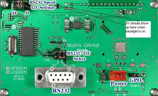

When you turn on the backlight with a program like uproject, the backlight should show 5V. I have showed the location of where it should read 5V. If you have the upper left pin of the transistor reading 5V and the right side of the transistor, which is connected to pin 16, 0V, then you have a bad transistor. If you get 5V, then there is something wrong with the display. The picture below will illustrate the location of the transistor.

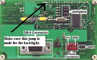

I think I may see your problem. Please ensure that 2 jumps are made accordingly for the backlight as shown in the following picture. Let me know if this works!! :D
Thanks to both of you for your help :)
I completely forgot about those jumps (now that I think about it there was a dot of solder there and I wasn't sure if it belonged)
