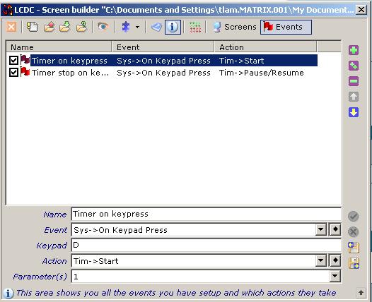

I have a mx412 and was wondering how to start timers. I go to events and screen specific the screen i put a timer on then I select the button and the action is the timer start. Am I missing anything it dosent seem to work.
Also what what do I have to do to just display the good old time it seems to be displaying millitary time on somewhere in europe right now.
thanks
Hi ghost2501,
I have attached a picture to show you my event settings to make the timer start. Your key will b different from mine though.
Try using the Secondary date/time selection to get the right time.
I hope this helps.

You can change the date/time format in the config screen. Also in the plugins configuration you can also set up alarm times as well.
