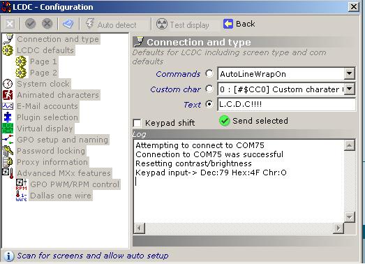

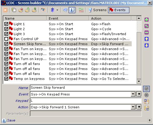

You can program your keys to display different screens or do different functions in LCDC. I have included an example of what you can do in the picture below. The picture indicates the programming of having the display skip to the next screen when you press a character.
To determine the character you get from the keypress, you can press a key, and the character will show up on the test log in the Test/Configuration section shown in the picture below.
- keypress.JPG (45.14 KiB) Viewed 14453 times
- KeypressForward.JPG (65.03 KiB) Viewed 14452 times
