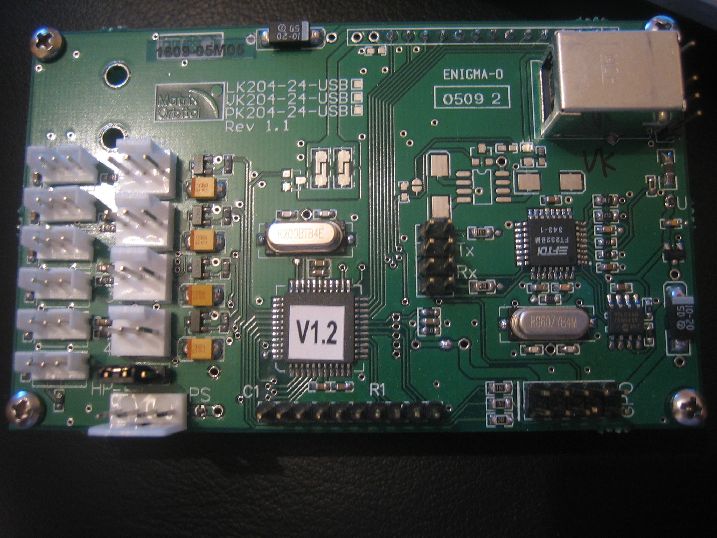

Got a lovely VK204-24-USB VFD here been using for a while. Other day it just died and I cant even get to display the matrix orbital boot screen. Funny thing is, I cant see ANY sign of shorting out or burn marks or anything. I can try to upload a pic of the back of it if need be but it literally looks in as new condition with nothing obvious that shows a sign of failure. What can I look for to check if I can repair this myself? I dont mind doing anything to make this work i.e. soldering etc, I just dont know what to look for. Are there any "pencil mods" I can perform like wiht graphics cards? I notice there is an area that has a component labelled "FUSE 1" on the front.
Like I say it has been working fine and I know that when I have applied JUST power to it in the past it has atleast displayed the matrix orbital boot logo, but now it is dead and does not even display this. I think it will be to do with when I was moving bits around in my case the other day and I may have shorted it out. But nothing smells of burning or any marks.
Please advise. I will do anything to get this working.

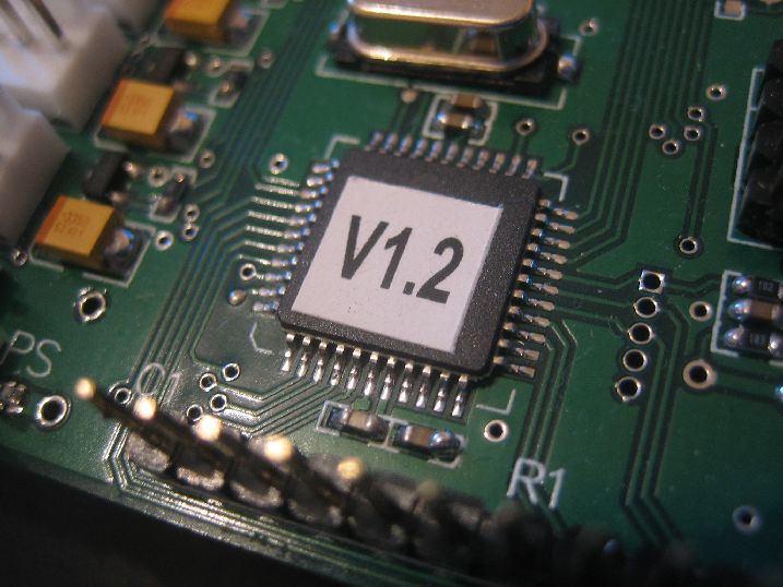

Also a shot of where I have seen burn marks before when someones died but mine has none (on the v1.2 bit)

Do you have a multimeter? The fuse right next to the unmodified power connector may have blown, so you can check whether there is continuity there. It's a 0 ohm resistor to the right of the connector. It is small, but you'll be able to see it.
Please email me at support@matrixorbital.ca , so we can also discuss RMA options.

I have emailed that address Tom as requested. I will try to obtain a multimeter in the mean time to help with testing. is there any thing else I can do in the mean time and what exactly do i need to do with the multimeter when i get hold of one.

I have tested the transistor with a multimeter by placing the red probe of multimeter on resistor and black probe on ground of unmodified floppy connector terminal prong, and I get a readout of 5.09 volts. I dont get anything in the same way off of the "FUSE 1" on the front of the VFD.
What else can I try?
