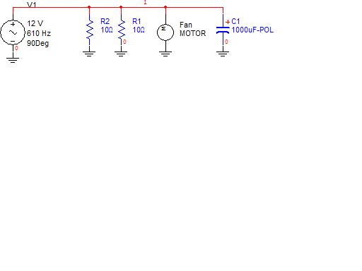

The best thing I have found is adding this to each large fan. It is better than mCubed version. There is minimal voltage loss and my clicking and purring large fans quieted down some with this. You can buy all the parts at Radio Shack, 2 10 ohm resistors, 1 1000microfarad electrolytic cap and a female and male fan connector which you can salvage from a Y-connector like I did. I measured the square wave with scope and the best frequency seems to be 400-610hz. The fan will have 10.4 volts going to it. With the fan out of the picture it's an open circuit.
- Circuit Diagram
- Fan Silencer.JPG (10.25 KiB) Viewed 4004 times
