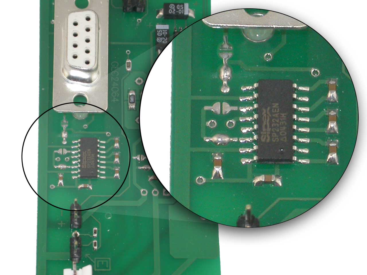

In order to communicate via TTL (through the RS-232 connector) please reference the attached picture. The jumpers in this picture are set to the default values. You must remove the solder from jumper 1 and 3, and place solder on jumpers 2 and 4.

From your photo, it doesn't look very inviting to that solution. I've done it, but pins sticking up from the board held in place by nothing but solder - especially in twos - is a little ugly...
I believe that some of our other boards have a slightly better layout for that.
You could, I suppose, run wires out to a piano switch crazy glued to the edge of the board - done that too...
