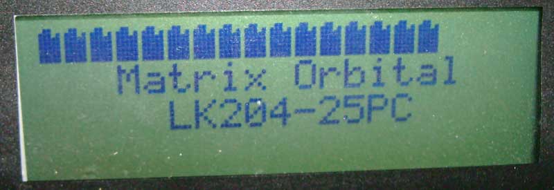

1. It seems the characters are not really basic sqaures or blocks as I first thought. I have attached a picture of the character in question to this post. Maybe the first step to fixing out how to get rid of it is to figure out wtf it is...
2. The LCD outputs these characters one at a time in a neat little row until the first line is full then it just moves on to the second line and seems to loop forever.
3. I did not take a stopwatch to it, but it seems to output on of these characters every 3ish seconds or so.
4. This problem only happens when I am hooked up to the BS2 in TTL mode no matter what the baud rate is. When I change it back to RS232 mode and hook it up to my computer everything is 100% fine.
Please let me know anything anyone can think of since I am pretty stuck on this one

***************PROBLEM SOLVED***************
I found the fix to this little problem on the Parallax forums. Turns out it was a simple problem with the way my code ended. So I was using this
The above code gave me the stupid character and this code fixed it:
I am still looking in why this fixes it, but it seems after you output to the LCD you loop the the code to do nothing.
I hope this helps anyone that has this problem in the future
-Brann
