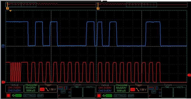

I will get you the scope captures tomorrow (because I'm not the one doing it, and the equipments are not at my place either), but I can explain some weird things about them right now. For one of the lines (I think it was SDA line) the voltage seems to drop below 5V while the other one stays at 5V with no problem.

Thanks for the capture.
I see that you are not getting ACK'ed although you are sending the right address. Can you please turn the power off, take off any keypad connected, and temporarily jump pins 6 and 7 of the keypad connector. Power the display back up and see if you get ACK'ed by the display.
Also, make sure that the lines idle high at the end of a transaction (I guess this should go without saying, when you STOP a transaction).

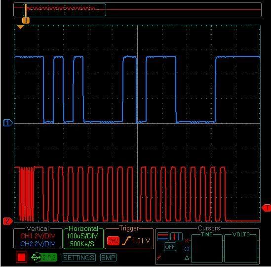

I looked at the data sheet for the PIC18F252 and it seems that the pins for SCL and SDA are port pins C3 and C4. Just making sure that this is where you are connecting the display to. Also, the GLK12232-25-SM does not have pull-ups. You will need to put them on your master end. Thing is, I do see the waveforms (as you have captured), so I guess mine is just a double check here.
Hi. I just got the scope captures and here they are now. For these scope captures, we used putcI2C() instead of putsI2C(). PutcI2C sends one char at a time, while putsI2C sends a whole string at a time. However, putsI2C doesn't have line idle high at the end but putcI2C does. Below is the new scope capture.
