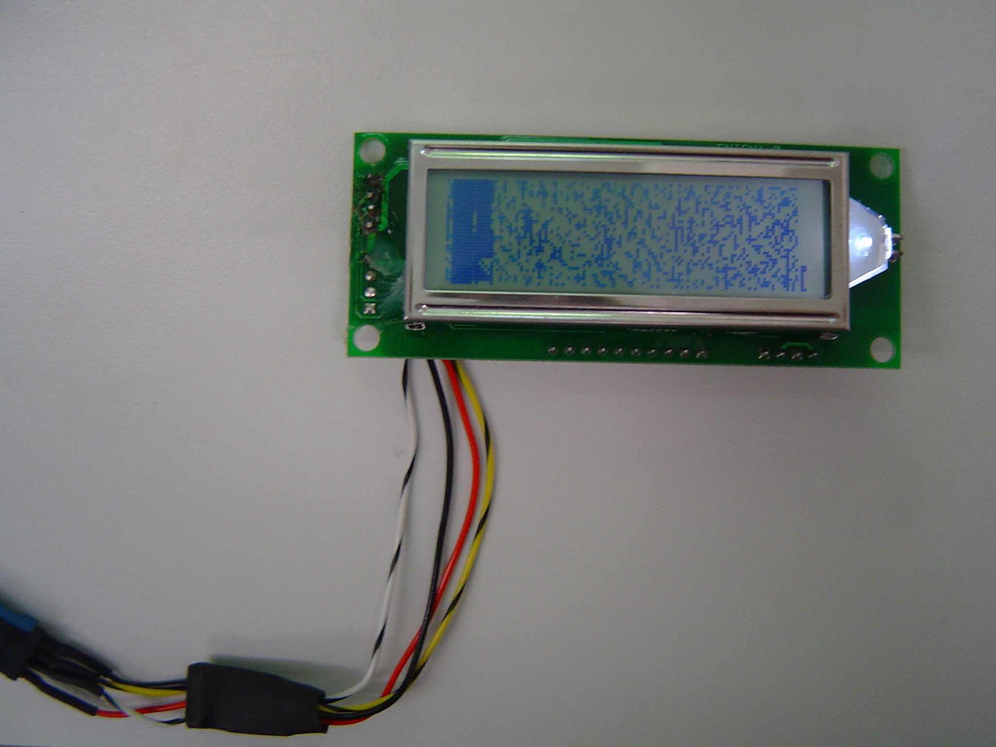

I have the display GLK12232-25SM and it shows only some kind of weird signs (see attachment).
When I change the "broken" display to one of the same kind, everything is fine. So there must be something wrong with the display itself.
Does anyone know what is wrong and whether it's fixable or not?
Here in Germany it's not really easy to find a vendor offering this display. Are there any models which can exchange the broken one? Newer model, easier to get?

the display is part of a laboratory equipment and shows the measurements and menu navigation. I have no information about how the display is driven.
I was searching your manual of that display (revision 3.0) and think that I found your advice on page 21 "Purge memory" and page 22 "Upload Font/Bitmap".
And that might be a problem because I don't have the files. But I still have two working displays. Is it possible to download the files of one display to upload it on the display with the purged memory? Making a 1:1 copy or something.
I was thinking that the display gets its entire information from some other microcontroller. But if some files are stored on the display I probably won't be able to get it to work even when I get a new display. Am I right?
Hopefully it will be possible to download the files, else I will have to contact the manufacturer and they will probably not give me that support. *keep fingers crossed*

Hello Stephan,
I am guessing that you have GLK12232-25-SM PCB Rev 1.4. This revision does not have the capability of being queried for its uploaded fonts and bitmaps, and hence you can not copy it.
The default settings on the GLK12232-25-SM PCB Rev 1.4 are:
1. Font 1 - Small Filled
2. Bitmap 1 - (as attached)
I can give you both these files, but then if there are other bitmaps/fonts then you will have to find them yourself (unfortunately).

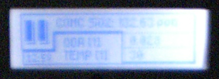

So is it true that the position of the displayed measurements which are displayed in zells and are arranged somewhere on the display are stored in files and uploaded to the display (see attachment)? Meaning that if I hook up a brand new display without any uploaded files the contend displayed will look different?
And it is not possible to "download" these files from a working display?
In my first post I asked if there is a compatible newer model which can exchange this one because this model isn't as easy to get. Is there?

Hello Stephan,
With the picture you had attached, it is possible that this may have been drawn by sending rectangular commands, but then most likely, this may have been a bitmap and some parts of being are being refreshed. It is hard to tell.
I am not sure if a brand new display with just the default files will work. The host may be drawing things on the fly, or even uploading bitmaps, or the users before may have pre-loaded the fonts/bitmaps before connecting the display to the system.
