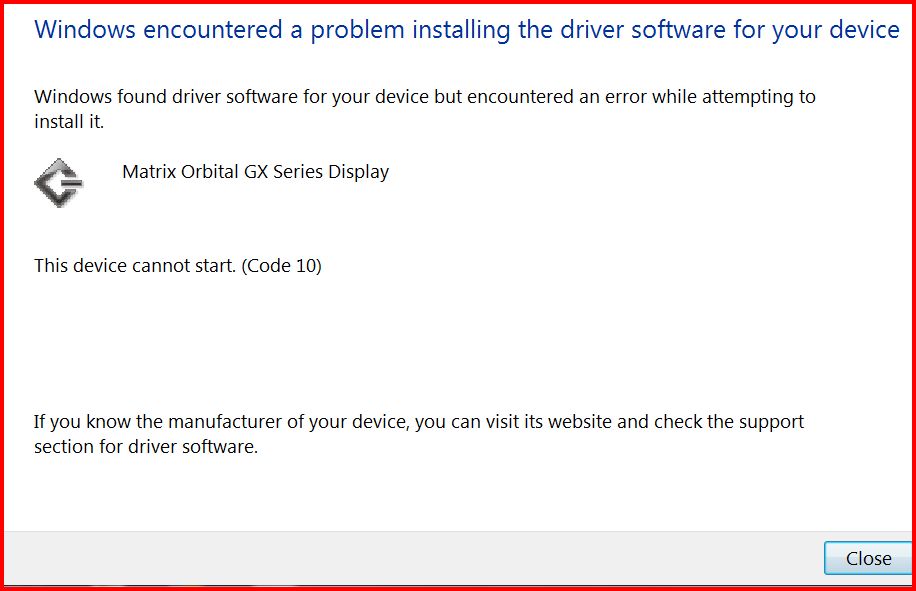

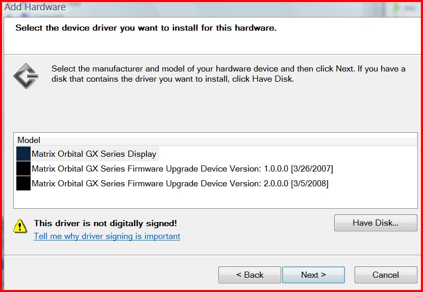

The main issue Is getting Windows to find the hardware. There's nothing for the software to work with because it doesn't locate the display. I managed to find and manually install it under (ADD LEGACY HARDWARE) in Device Manager... but it will not run, or find the drivers when I direct it to them, yet Vista indicates that the software is up to date... of course windows will say that if you insert a stick of gum in a usb port... But of course still nothing on the display.. any ideas...Please?
For some reason links aren't highlighted from where I'm sitting, didn't notice it...

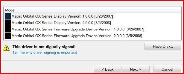

Nope. Nothing ever happened when I plugged in the display, except for the backlit logo. Windows never blinked. I've tried a different usb cable, different ports, rebooting, bios configs, even uninstalling every other single usb device then rebooting with only the display plugged in. Nothing. Like I said, under the Add Legacy Hardware I get four possile IDs for it, but when I try to update software and point it to my GX folder, it doesn't find it, yet ends with stating that the software is up to date.. LCD studio can't find it.

Well if the device doesn't turn up on the usb bus you can try to force load any driver but it will not magically fix the device not being on the usb bus.
In all honesty sounds like faulty hardware, its unfortunate that it took this long to figure this out usually we'd RMA the unit but contact tclark@matrixorbital.ca with your contact info and we'll ship you a new one.

Obviously that,okay. But you see, as it turns out the "legacy hardware" Vista list is already in it's big brain, verses me thinking it actually found the display.
I can force it to automatically find the software, but then it gives me assorted polite error messages about finding the software but having either a problem locating the specific device, or a problem installing the software. There just doesnt seem to be any connection to the hardware except for the fact that it lights up.
