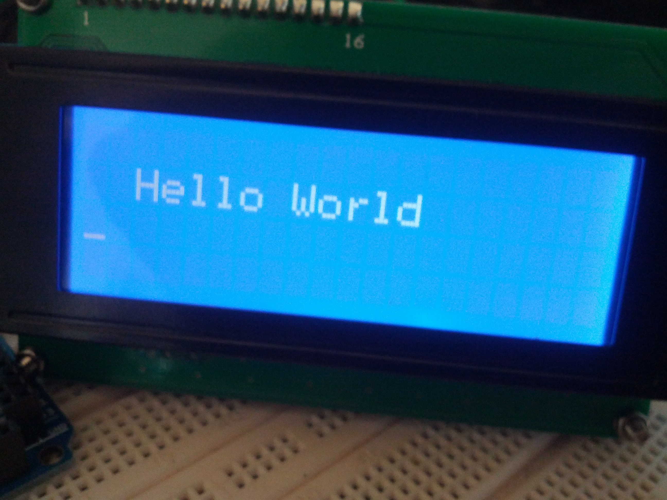

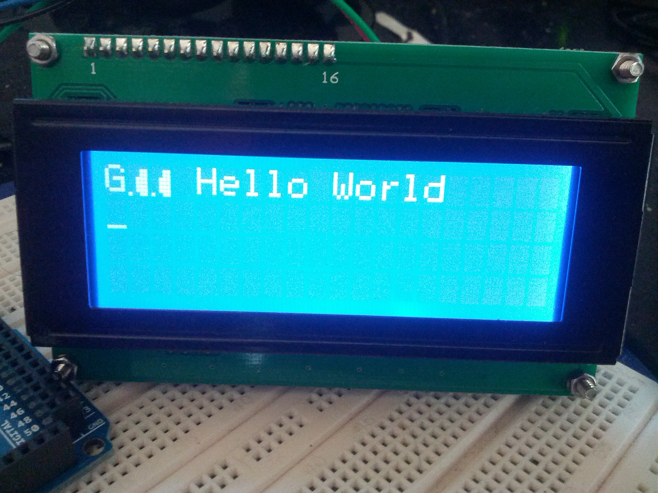

Here what happen when I want to use the set cursor command.
I remove this part of the code before the set cursor and it work perfectly.
I don't know why but it work.

After I remove the part of code
What happen when I want to use the set cursor command
