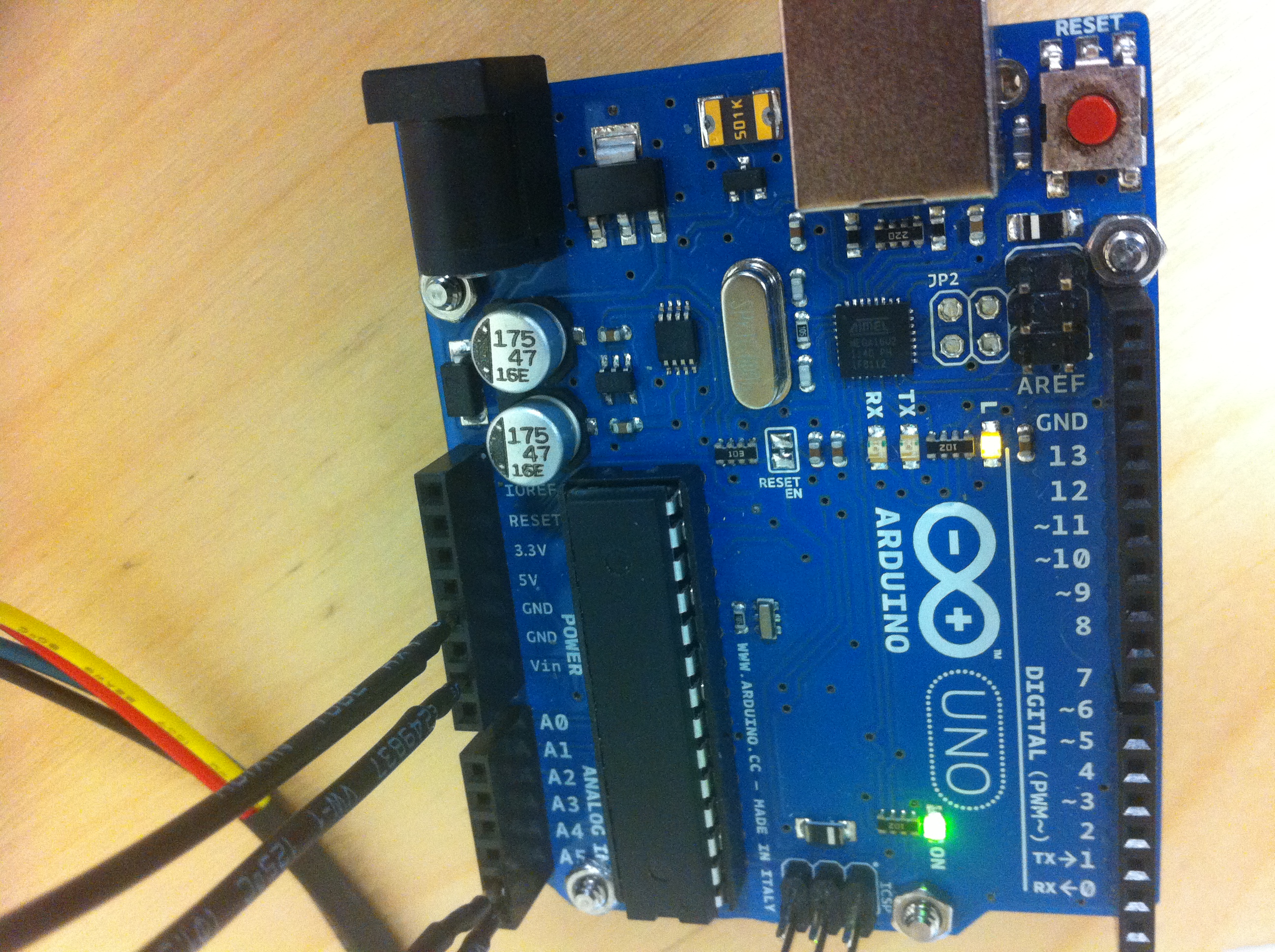

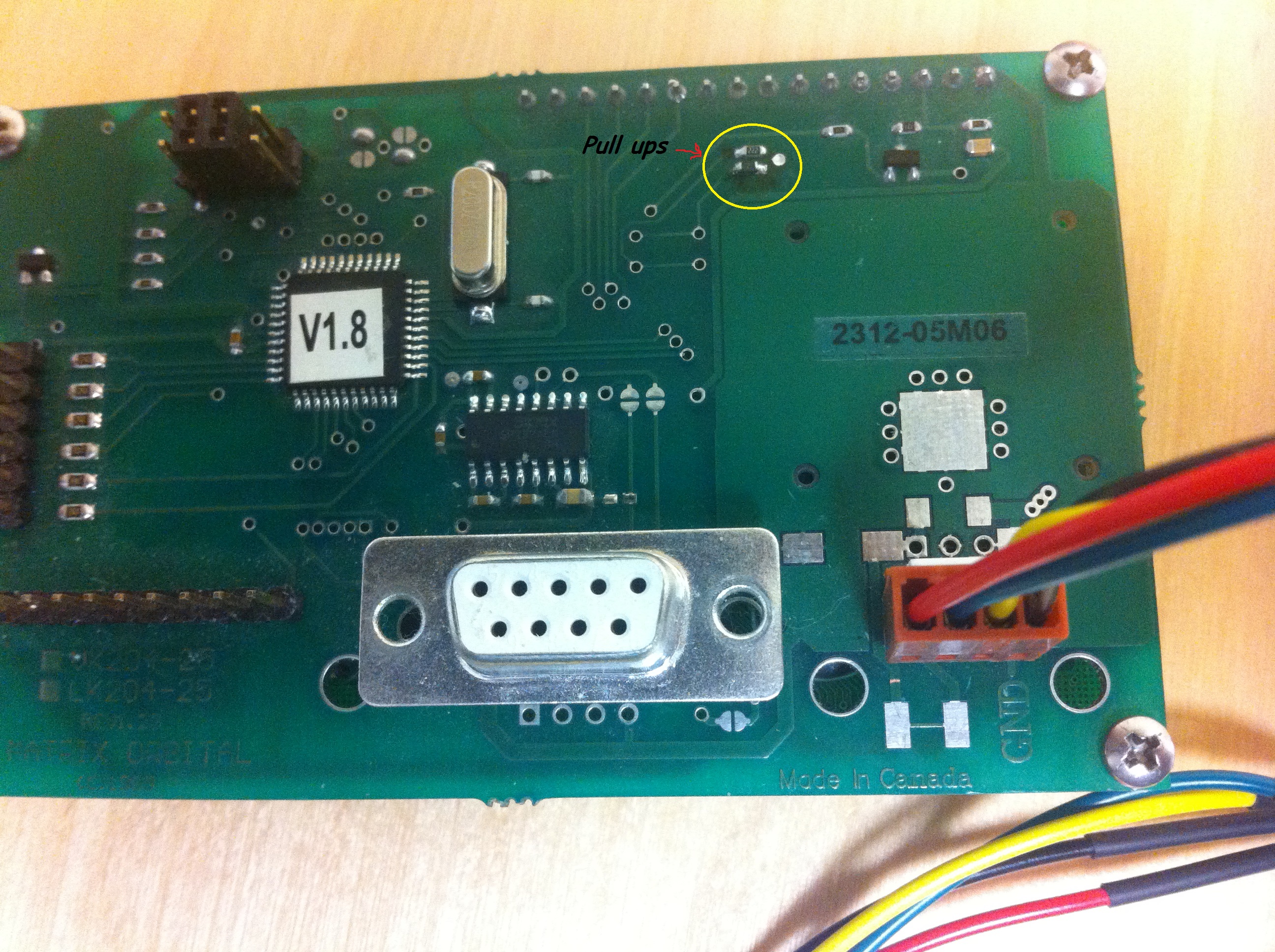

My jumpers are also on J1 and J2. Also I am using Internal pull ups on the LK204-25 itself.
I am using a Arduino UNO Rev 3. My SDA and SCL lines are connected to the Analog 4 and 5.
SCL line is connected in A5 and SDA to A4.
I've attached a photo of my Arduino to show how I have my display connected and a photo of where the pull ups are located on the display.
Where the pullups are on the display is where you may be receiving your short.
If you have any other questions or concerns please don't hesitate to ask.
Thank you
Martino
Thank you
Martino

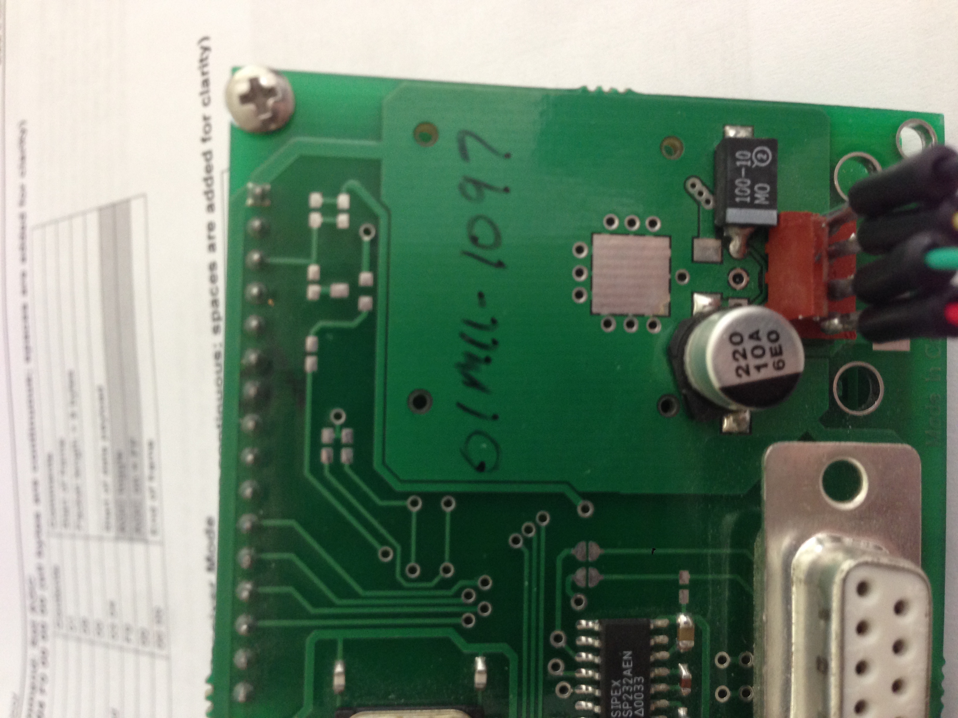

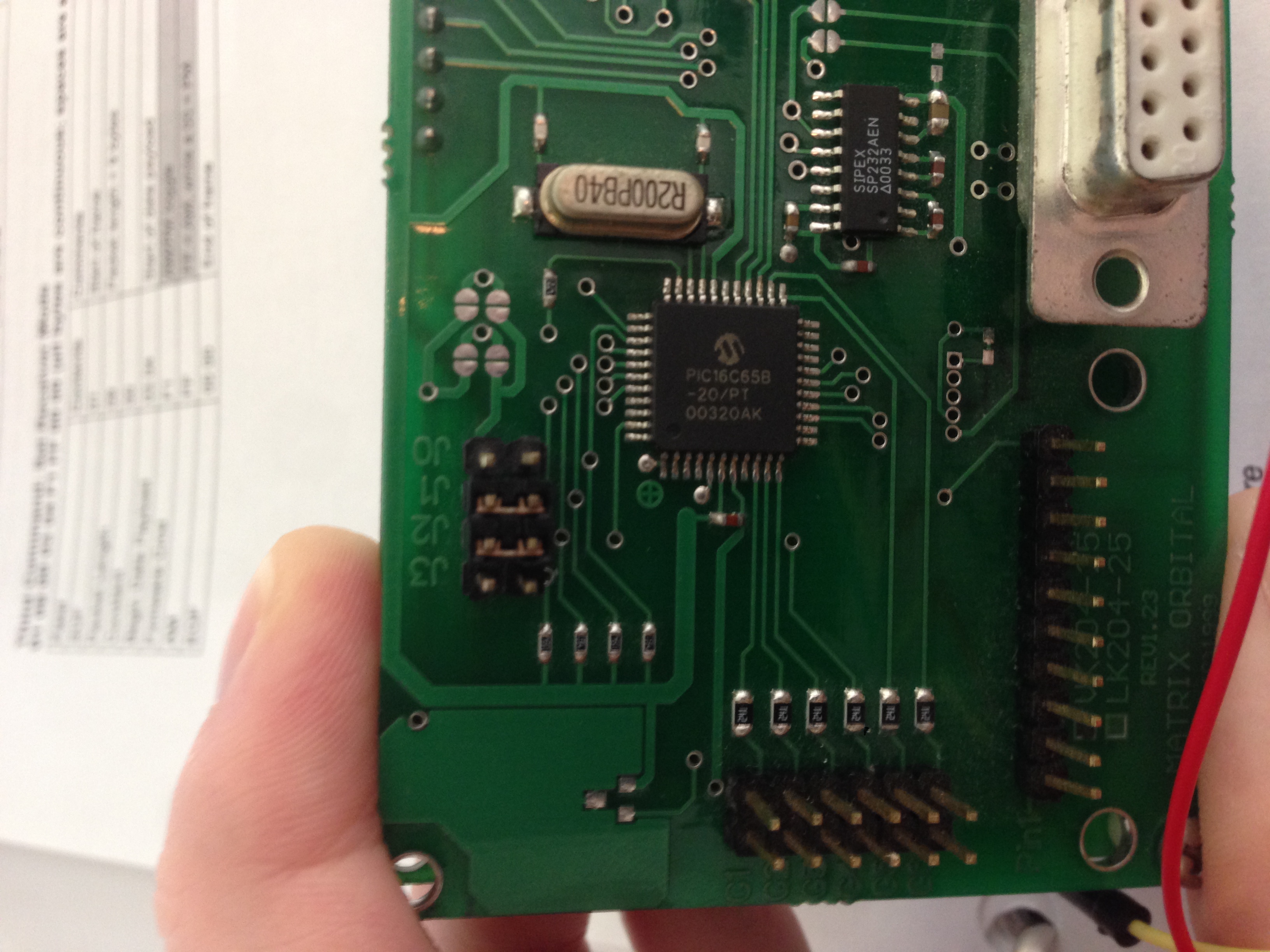

My board seems to be populated with quite a few different components than yours.
Also, the solder pads next to the J0 - J3 jumpers on yours are bridged, mine are open.

As you can see there are no pullups on my board where they are on yours. The screen works fine over a serial port, I assume if there was a short on the i2c bus, then the screen wouldn't work at all, but I may be wrong. Does the serial port connection use the i2c bus internally?

The reason you are receiving a low signal from your I2C lines is because there are no pull ups on your board.
You will need to populate the pull ups in order to use I2C, please do so. Let me know if it works after you do so.
