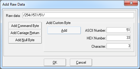

When you set the display to manual override and have powered the display on:
remove the jumper
with uProject open, go into the "Uploader" menu.
In the left menu of the Uploader select "Raw Data" which will be in the "Other" drop down.
Send the "Changing the Baud Rate" command.(Ive attached a image of what the "Raw Data" window should look like with the command entered)
After you have entered the command select ok and execute.
Note: The Baudrate I have set in the command is 19200.
Please try this and let me know if it works.
If you have any other questions or concerns please feel free to ask.
Thank you
Martino

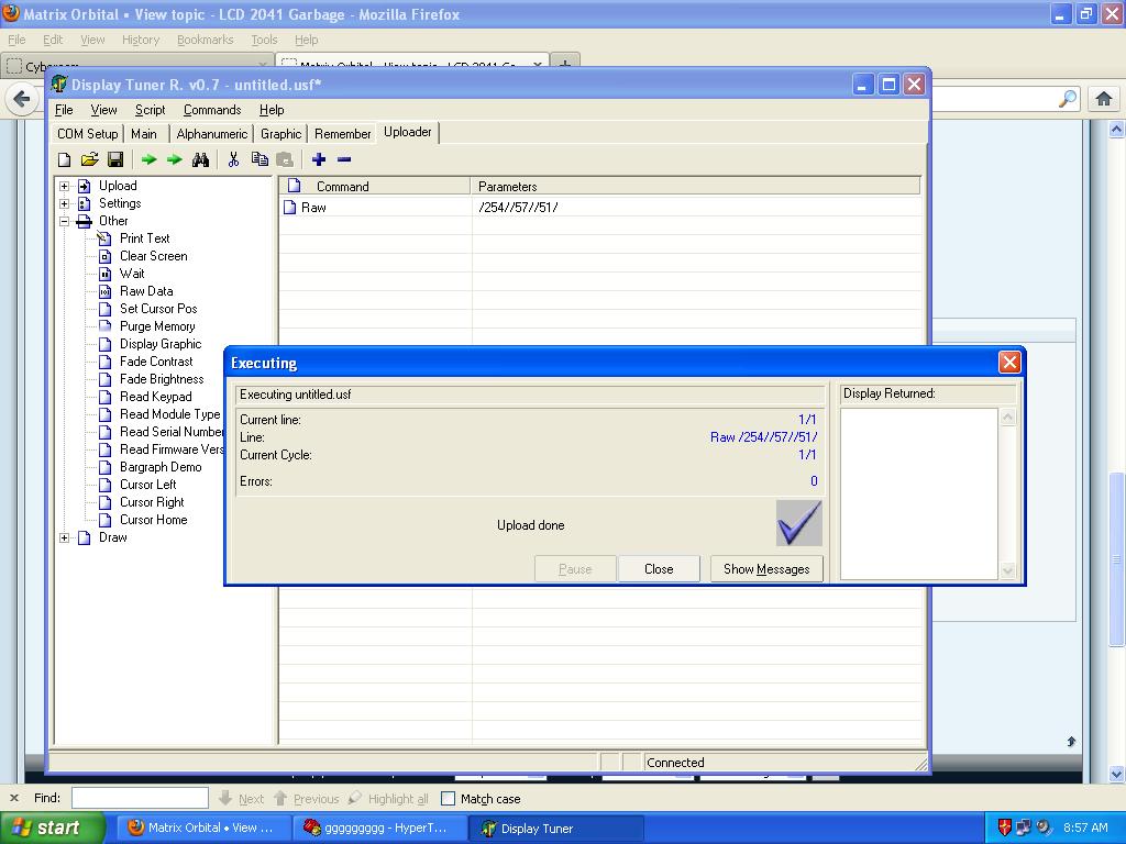

Re: LCD 2041 Garbage
Hi Tino,
Thanks for your reply, I tired with what you had suggested, the message is also showing upload done.
But then when I go into main menu and select the "Load startup screen" and press ok., its again showing all the garbage values.
I'm not sure where exactly I'm missing the trick.
please suggest.,
Sid
please suggest.,
Sid
- img1.JPG (116.07 KiB) Viewed 9527 times
Hi Sid,
You are not doomed.
Are you looking to reset the Start Screen back to the default?
After the start up screen on the LCD2041 is changed you can't necessarily change it back to the original. We have a program that you can use to set the unit back to the start screen though. It is called BootEdit and another is called BootLogo. Personally I use BootEdit. They can be found here:
http://www.matrixorbital.ca/software/software_alpha/
To reset the settings (ex baud rate) set the display into manual override.
Then send the change baud rate command found in the manual - this will save the baud rate to what you want.
After the settings are saved then try sending text to the display.
After you change the baud rate be sure to change the settings in Hyperterminal and uProject so you are sending the data at the right baud rate.
