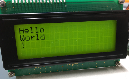

Dear All,
I have an LCD2041 and in the normal operating mode it is displaying only garbage regardless of what I do. That garbage is constant, it does not change and cannot be deleted. Please see the attached file. I can use the 2041 only in override mode. Can you please advise?
Radu
Radu
- WP_20170502_10_59_32_Pro.jpg (4.16 MiB) Viewed 68564 times

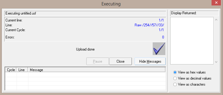

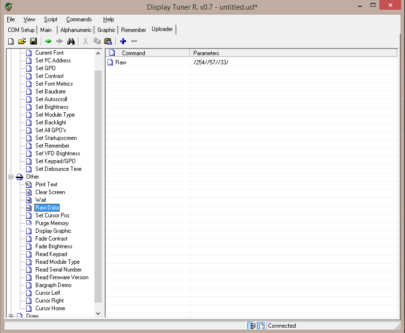

In the override mode I am able to communicate with the LCD. Please see in Step1.png the command and is Step2.png the result of executing the command with F9. After executing the command I powered off the device and removed the J0 jumper. I powered the LCD back on in normal mode and I saw the Step3.png on the display and regardless of what I send over via uProject.exe nothing changes. In normal mode I used the baud rate of 19200 which was set in the override mode. Do you know what could be happening?
Best regards,
Radu
Thank you for your reply.
Best regards,
Radu

Hi Radut,
Thanks for your troubleshooting. I appreciate how you have provided images of each step you've taken.
I've reviewed the values you sent to the display in step 1. Your uProject formatting, command byte, and command prefix are perfect, but the "33" value you have sent to your display is actually a Hex Value. You will have to convert the hexadecimal value 33 to decimal prior to sending it to the display.
33 HEX =51 DEC.
Please try booting your display in manual override once again, and send the following decimal values via the Raw Data command:
/254//57//51/

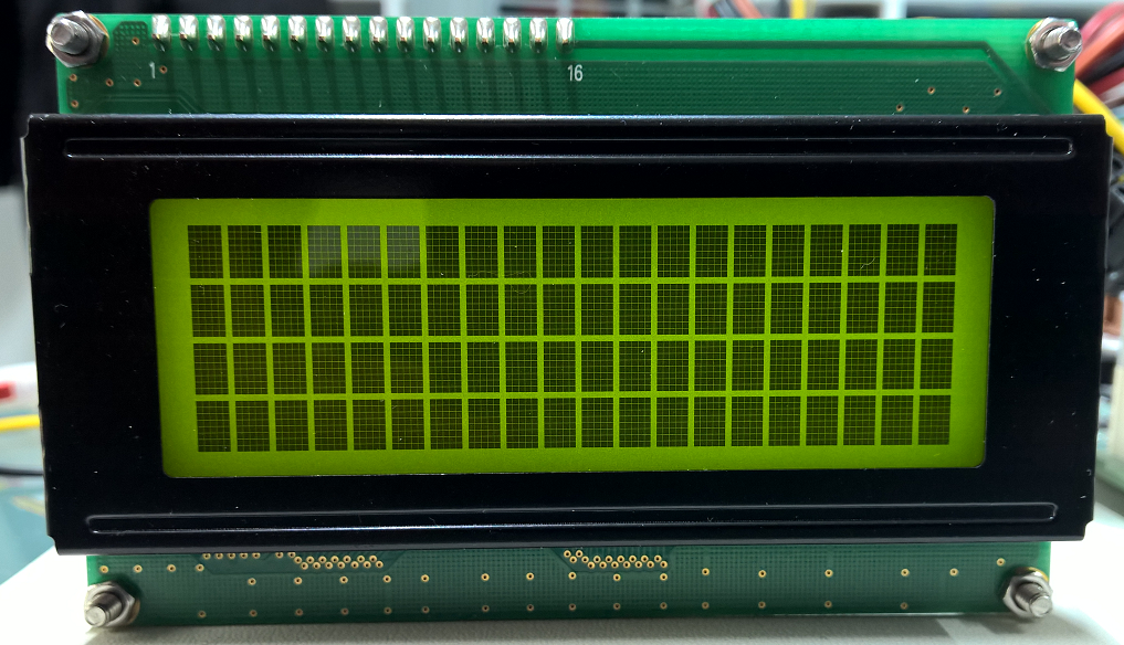

Also, judging by the image for Step 3, you may want to set the contrast of your display as well. You can set and save the contrast using command 8.7 found in the user manual. Factory contrast settings can be set by sending /254//145//128/
Please give this a shot and let me know if it helps.

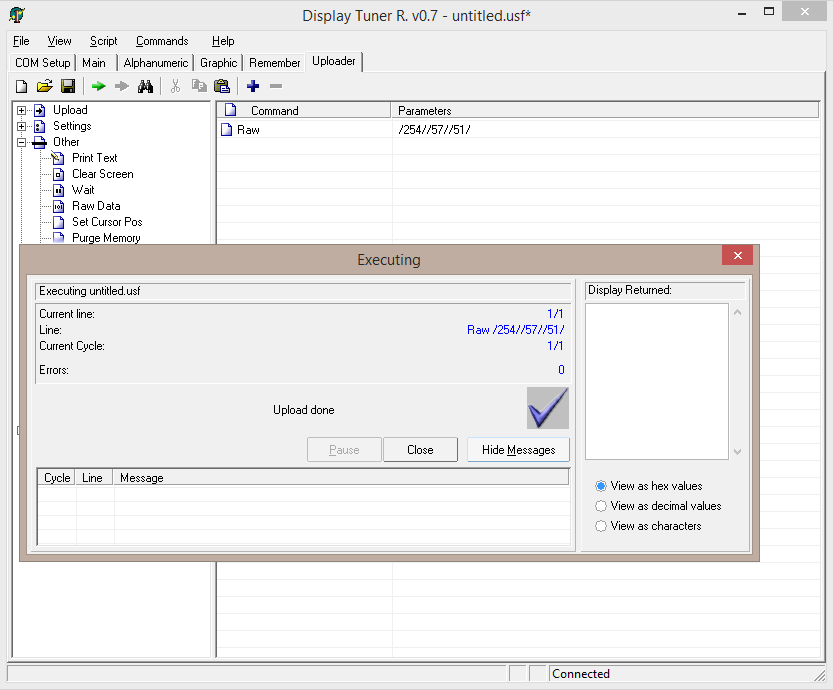

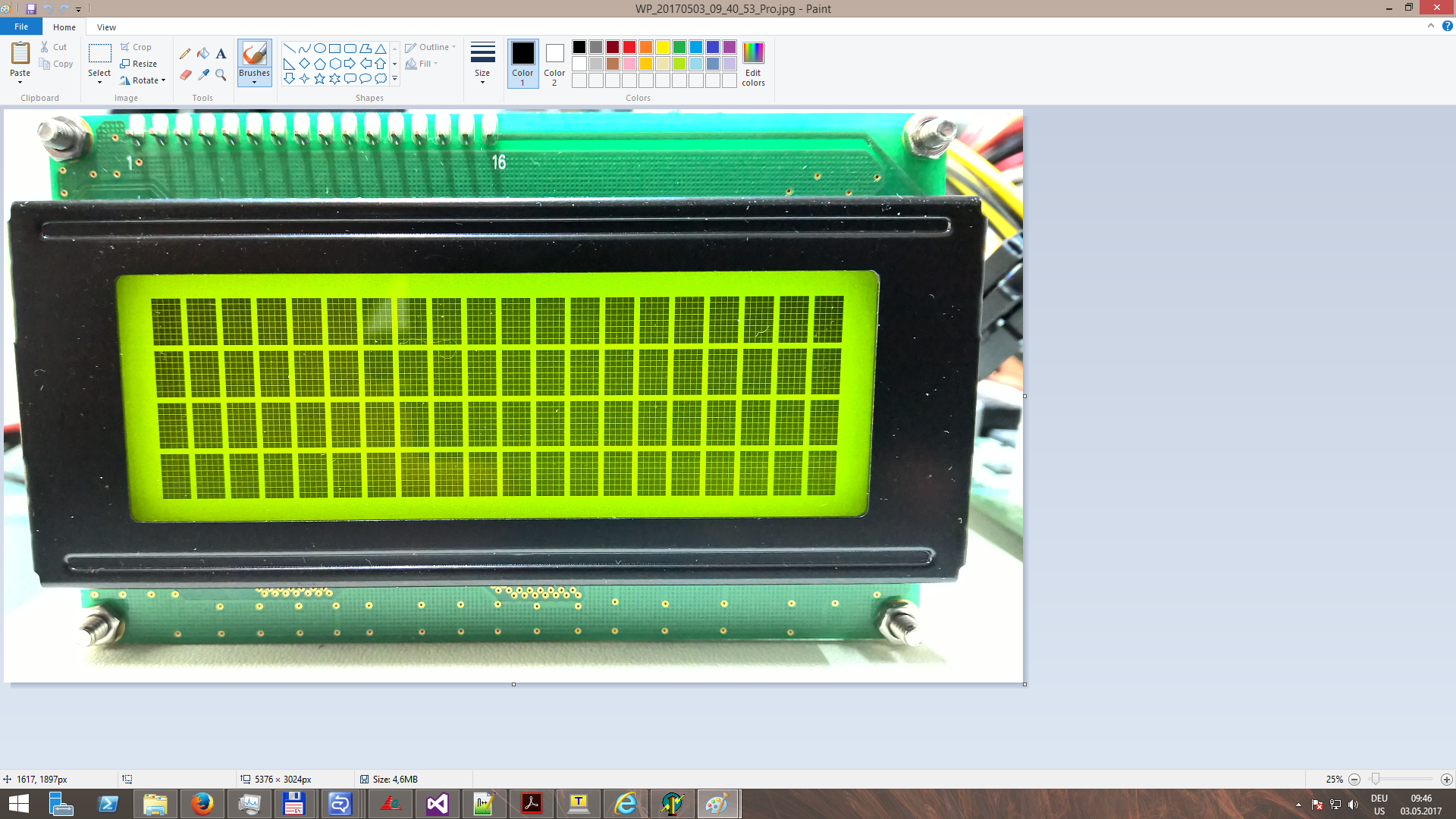

Dear Daniel,
Sorry for my mistake, I did not pay attention to converting the hex value to dec.
I put the display in the override mode and sent the command as seen in Step1.png.
After that I rebooted to the standard operating mode and connected to the display as seen in Step2.png, the connection status is always good.
And after restarting in the standard operating mode the screen looked like Step3.png :( After I connected to it via uProject.exe as seen in Step2.png, I still was not able to clear the screen or send a text message to it. The LCD displays what is shown in Step3.png.
Best regards,
Radu

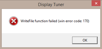

Dear Daniel,
In the normal operating mode, the commands failed. Please see the "Module type.png" for the "Read Module Type" command and the "Contrast.png" for setting the contrast command. The display does not change the contrast.
Best regards,
Radu
