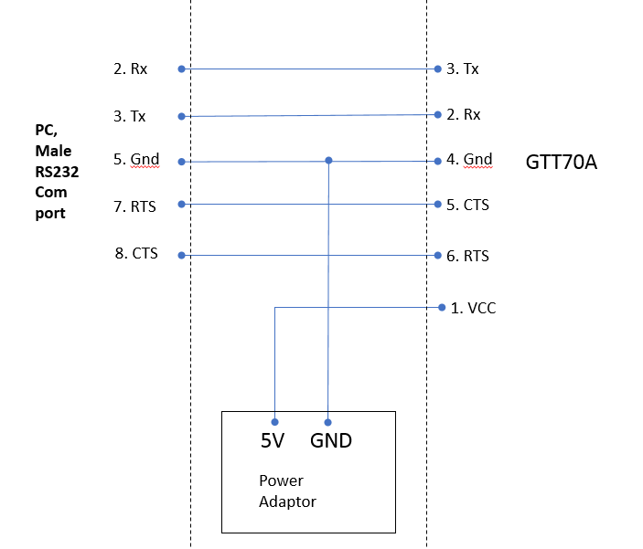

We did not brought the accessory Rs232 and power cable, thus we are making our own cable.
Can u pls advice whether pins signal connection are correct? - We had to make several attempt before we can get connected with GTT support tool(2.2.0.0).

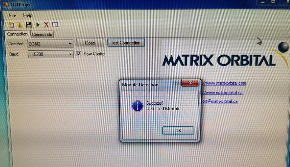

- When there is no response , 2nd attend of "test connection" will get “hang” as below pic. Thanks.

Your connections to the GTT70A data/power look correct. Try to do a continuity test to make sure the connections are made.
Does the GTT70A power up with a GTT startup screen? Can I please get the PCB version of your GTT70A?
Also, please make sure when using the GTT Support Tool (click on "Test Connection") that the correct ComPort is chosen.
The default baud is 115200.
The ESCCPC5V should be able to help out with a quick solution.

I had difficulty getting connected to the GTT70A with support tool, normally need several attempt of power on/off the GTT70A or the PC before i can finally get connected to the GTT support tool.
- My device manager is COM port 2 setting 9600( default). GTT Support Tool's baud rate (default 115200).
- When Flow control is set to none, It is always no device detected. - Only when set Flow control, there is chance to get connected to GTT support tool. - If failed to connect with set Flow control, the symptom is "hang" as mention in first post.

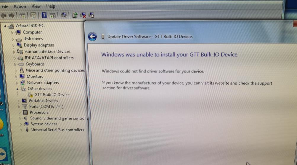

Next is GTT designer. After plugin in USB cable to the mass storage header, i found there is a unknown IO device.
Can i know where to download the driver? Thanks.

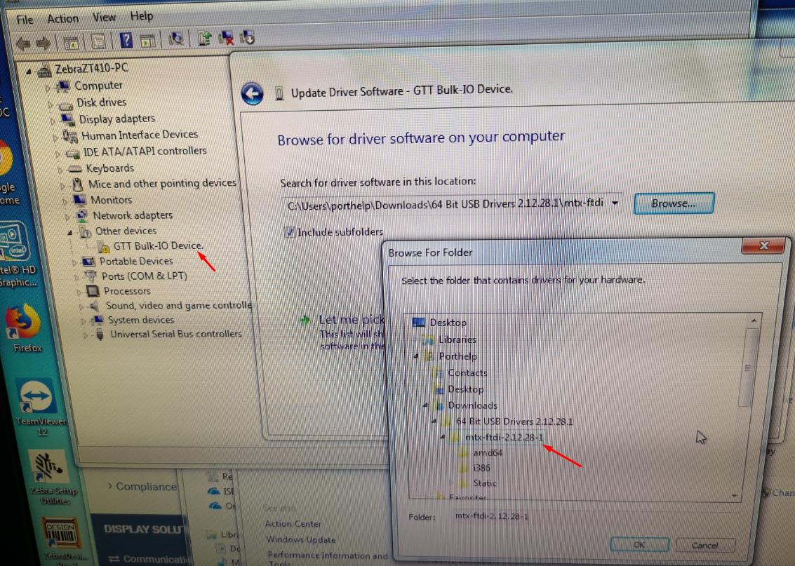

Regarding trying to detect GTT70A with the GTT designer, unknown IO device appear when plug in to the mass storage header, i could not get the driver install correctly.
I had downloaded the 2.12.28.1 version but it seem not the correct driver. pls refer to the pic. If i tried to let the windows to search automatically for updated driver software, it will install the GTT bulk-IO device to BIDI! Is this the correct driver? My OS is Win7 Pro 64bit.

The USB driver that you downloaded is correct.
It looks like 3 of your images did not display properly. Could you try posting your USB driver images again? I would like to know which errors you are getting when trying to install the USB drivers.

Attached is unable to detect pic using the driver download. If I allow windows to search automatically, it will detect as BIDI which is a HP printer.

I think i had some answer for the GTT Bulk-IO driver. This GTT Bulk-IO cannot be resolve from the USB driver from yr website. The USB driver2.12.28.1 version should be the driver for the GTT USB model. I still cannot resolve the GTT Bulk IO using Win 7 Pro 64bit OS.
But when i switch to Win 10 64bit OS, the GTT bulk IO is automatically installed. The GTT designer will automatically detect my display once i run it.
It seem the GTT Bulk-IO cannot detect properly on Win 7 OS. I had tried with different PC using Win 7 OS but same result. Note, this is juz my findings.

After testing the issue here on a few different PC's, I was able to replicate your issue on an older build of Windows 7. It appears that you are correct. In my case, the WinUSB driver was not automatically installed for the GTT Bulk-IO device.I had to use a third party program to install the WinUSB drivers required on Windows 7.
You can download the 3rd party program here: https://zadig.akeo.ie/
Make sure you install the WinUSB driver for the GTT Bulk-IO device.
The WinUSB drivers installed by the third party program resolved any driver issues listed in device manager. That said, I'm still having difficulties detecting the GTT in the GTT Designer.
I'll consult our software team and determine what might be preventing the display from being detected. For now, please stick to Windows 10 as it sounds like you'e able to communicate properly.

Hi Daniel,
I got the Gtt70A USB model, I do not have issue connecting to GTT support or designer tool in Win10 OS, unlike the Rs232 model.
My GTT70A RS232 model still have issue connecting to GTT support in Win10 OS. Anyway, i stick to USB model in Win10 for now.
KH
