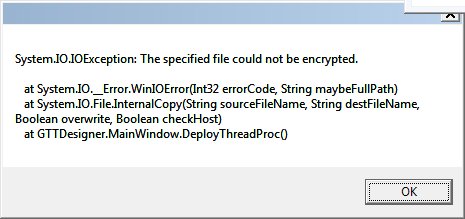

I am trying to deploy the GTT29A example project and get the following error when it tries to copy the files out to the display:
GTT error.jpg (25.31 KiB) Viewed 30250 times
It creates the directories, but no files are actually in them.

It's the demo project that I downloaded from your site. No changes.

Ah, discovered the problem. GTT Designer can't handle it if the project directory is encrypted under Windows, which it was. When I removed the encryption from the directory the problem went away. Suggestion: since some of us make a habit of encrypting directories containing important files, such as product designs, this should be fixed.
