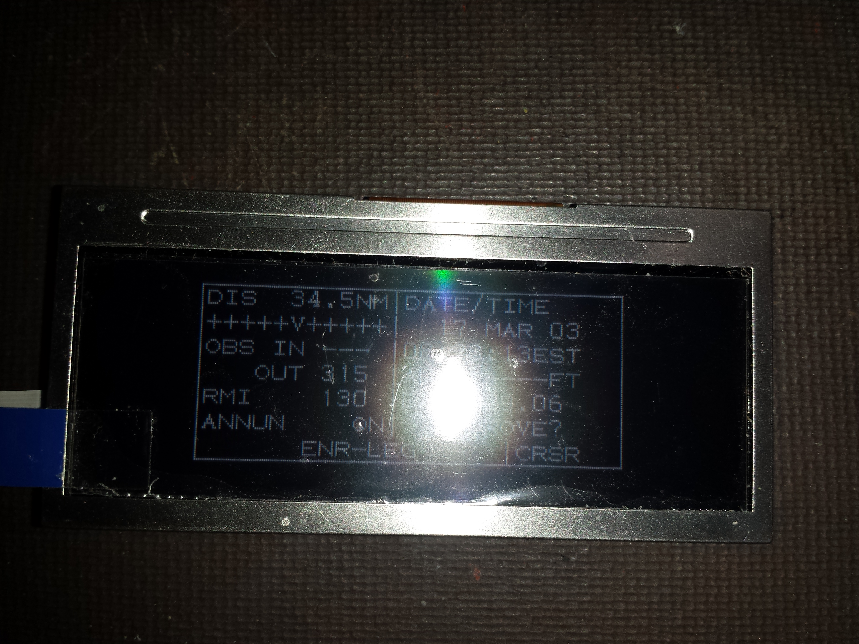

Re: Make EVE2-29A look like a green crt display
Picture of screen attached
- 20190523_150245.jpg (2.93 MiB) Viewed 14753 times
- LCD!
- Posts: 10
- Joined: Thu May 09, 2019 11:48 am
Notice how I got it to flip 180 deg?
