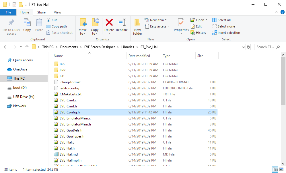

2. Once installed, open File Explorer and navigate to the location that the program was installed. By default, the program will be installed under C:\Users\Public\Documents\EVE Screen Designer
3. Open the Libraries>FT_Eve_Hal> EVE_Config.h in a text window.

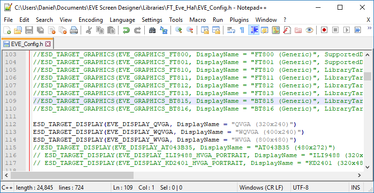

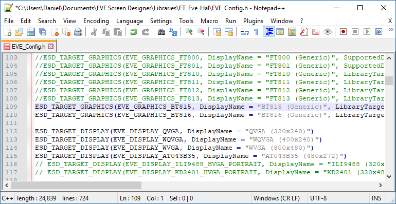

4. Scroll down in your text window. You should find a few ESD_TARGET_GRAPHICS and ESD_TARGET_DISPLAY functions commented out. Make sure to uncomment the following lines:
ESD_TARGET_GRAPHICS(EVE_GRAPHICS_BT815, DisplayName = "BT815 (Generic)", LibraryTargets="\b(BT81X|BT815)\b")
ESD_TARGET_GRAPHICS(EVE_GRAPHICS_BT816, DisplayName = "BT816 (Generic)", LibraryTargets="\b(BT81X|BT816)\b")
ESD_TARGET_DISPLAY(EVE_DISPLAY_AT043B35, DisplayName = "AT043B35 (480x272)")

Save the file and close the text editor window.

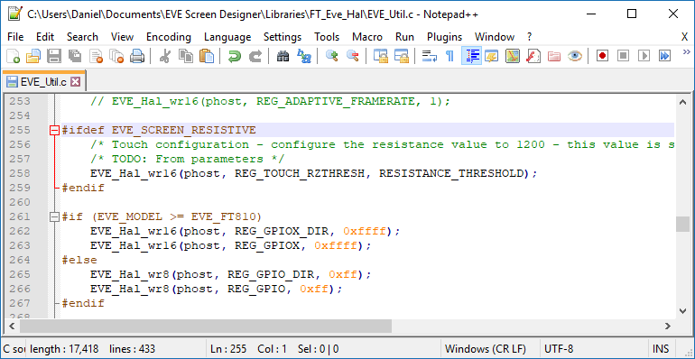

5. In file explorer, open Libraries>FT_Eve_Hal> EVE_Util.c in a text window.
Locating EVE_Util.png (79.3 KiB) Viewed 30598 times
6. In the text window, search for "EVE_SCREEN_RESISTIVE". The text window will bring you to the following #ifdef block.
Copy and paste the following code immediately under the EVE_SCREEN_RESISTIVE #ifdef block.
#ifdef EVE_SCREEN_CAPACITIVE
EVE_Hal_wr16(phost, REG_CTOUCH_EXTENDED, CTOUCH_MODE_COMPATIBILITY);
EVE_Hal_wr16(phost, REG_CYA_TOUCH, 0x5d0);
#endif
7. Save the file and close the text window.

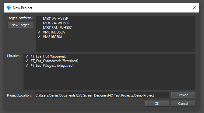

8. Start the Eve Screen Designer application. When prompted, create a new project. You can select any of the targets listed, but we suggest you specify the VM816CU50A or the VM816C50A.

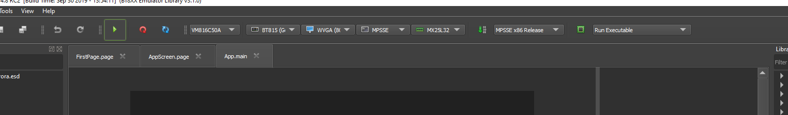

9. Once the project has been generated, you should see multiple drop down menus in the ESD toolbar. These drop down menus let you specify what Build Target, EVE IC, Screen Resolution, Communication Platform, Flash Capacity, Toolchain, and programmer you are using.
Please specify the EVE IC, Screen Resolution, and Flash capacity that is applicable to your EVE3 variant.
Specify an MPSSE toolchain, and Run Executable as your programmer.
