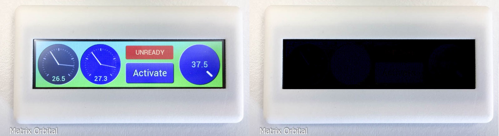

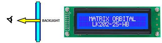

Transmissive
Most TFT displays and negative LCD’s are transmissive meaning they always have a backlight. A negative LCD is where the characters are the colour of the backlight. The backlight is used to illuminate the display, If the backlight is off, the display will generally not be readable. The backlight fights against ambient light, so in direct sun, a backlight that is sunlight rated is required or the display will become washed out, the brighter the backlight, the more visible the display will be in direct sunlight.
Transmissive Display
Transmissive diagram.png (73.77 KiB) Viewed 43266 times
TFT On/Off
TFT On/Off
Pro:
  • High contrast.
  • Lots of size and colour options.
Con:
  • Not ideal for direct sunlight or high brightness environments unless equipped with a sunlight capable backlight.

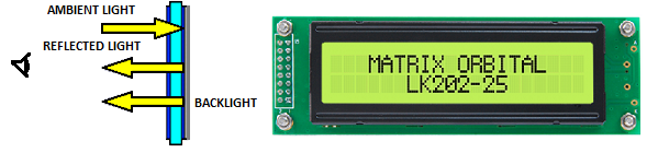

Transflective
Transflective LCD’s and TFT’s have both reflective and transmissive characteristics. The display will use ambient light as well as a backlight. A very common example is a yellow/green backlit LCD. Very few TFT display are offered in transflective.
Transflective Display
Transflective diagram.png (84.37 KiB) Viewed 43266 times
Pro:
  • Direct sunlight friendly.
Con:
  • High cost and low availability in TFT displays.
