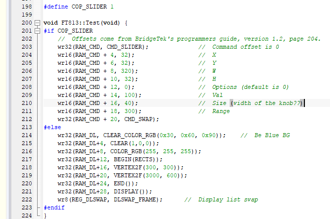

I could get started by using several examples and I'm able to initialize the display and write shapes using the RAM_DL
memory space. However, I still don't understand how to get the coprocessor working. Please look at what I have written (1)
When I use the RAM_DL part, (no coprocessor slider, #define COP_SLIDER 0), it works, and I get a white rectangle
on blue background.
As for the coprocessor "slider" command, I wrote it with wr32 and wr16 commands, but I'm not sure how to finish the list.
In the DL command method, there is write DLSWAP_FRAME command, but how can I close a coprocessor list?
Basically it does nothing. Coudld anybody tell me what's wrong?

Yes, that was my intention, not to write in RAM_DL, and therefore the attached picture shows that Ihave written everything in
RAM_CMD.

Code snippet 8 gives a full source code except the last SWAP command. This code is absolutely not ambiguous, and
the code I wrote in the bottom part (#else) of my code is based on code snippet 8. And the attached image has been done
the same way, all in the DL memory because I couldn't use widget sliders.
Snippet 8 is very clear because it says what I have to write and where, using wr32 which is basically a SPI command.
So if I write everything from CLEAR to DISPLAY, and then use the SWAP command, it works. In my application, I wrote
all the sliders by hand, but now I would like to use the coprocessor.
I know that if I fill FT813::Test() function with code snippet 8, and finish it with a swap command (wr8(REG_DLSWAP, DLSWAP_FRAME);)
then it works. Now I'm trying to do a simple slider in the CMD buffer. But for the time being, I will stick with the very first
documentation example in 5.3, which should produce (I guess), a red background.

void FT813::Test(void) {
	wr32(RAM_CMD, CMD_DLSTART);
	wr32(RAM_CMD + 4, CLEAR_COLOR_RGB(255, 0, 0));
	wr32(RAM_CMD + 8, CLEAR(1, 1, 1));	// clear screen
	wr32(RAM_CMD + 12, DISPLAY());
	//	Verify if something has been written
	mDLPos = rd32(REG_CMD_DL);
	//	Swap
Now the documentation says (5.3, interaction with RAM_DL) that the coprocessor manages
a register, REG_CMD_DL, and that this one should give me the position in the current DL buffer.
When I read the contents of REG_CMD_DL, it always reports 0.
So I guess I have to send an instruction to the coprocessor to tell it to translate the CMD list to DL list.
Could anybody tell me what exactly is missing here?
Best regards,
R

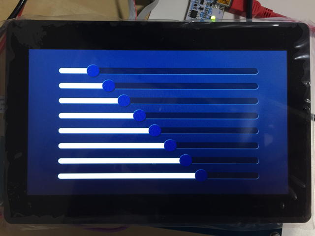

Hello!
I think I got it.
Here is the result:
R

Hello Raquel!
Something I don't find in the documentation:
1. Is there a way to write the slider in the opposite direction?
2. Is there a way to set another color for the white part? Apparentlty I can change only the
3. If not, is there a way to access the DL list generated by the coprocessor in order to modify it and
write my own widgets in the DL space?
R
Re: Using coprocessor (FT813)
Hello R,
If you please check out Table 18, Widgets Color Setup Table on the programming guide.
Also, with the color change, the color interpretation can be deemed the direction of the slider.
Cmd_FGcolor(MAKE_COLOR(255, 0, 0)); //Red Knob
Cmd_BGcolor(MAKE_COLOR(0, 255, 0)); //green right of Knob
Send_CMD(COLOR_RGB(0, 0, 255));     //blue left of Knob
Cmd_Slider(16, 16, 480-48, 16, 0, 128, 256);
