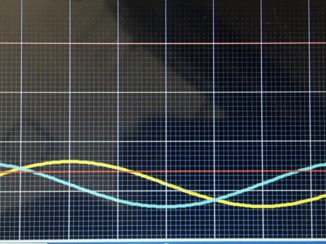

Ok, only claims would not be fair: I like the sub-pixel drawing which allows for instance to have a thinner subgrid.
